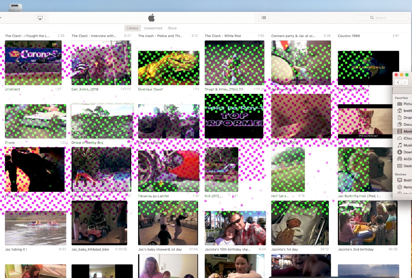

Hi, can anyone tell me if this screen fault , the pink and green pixelation is caused by the GPU[screenshot attached] and if this upgrade will fix it ? It's on a late 2011 27" iMac 8gb Ram with
ATI Radeon HD 5750 1024 MB graphics
Hi, can anyone tell me if this screen fault , the pink and green pixelation is caused by the GPU[screenshot attached] and if this upgrade will fix it ? It's on a late 2011 27" iMac 8gb Ram with ATI Radeon HD 5750 1024 MB graphics
Please try not to hijack other's threads - but to answer your question, yes this is 100% a GPU failure. Head over to the upgrade thread and give it a good solid read.
