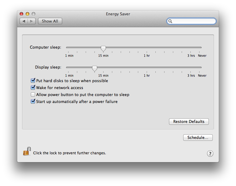

But, it could also be a Wake on lan problem, see if the box is checked, you can disable this by going to System Preferences>Energy Saver, if it was on this could be the problem so no need to do the terminal commands.
See screenshot below, I have it set because I need it.
