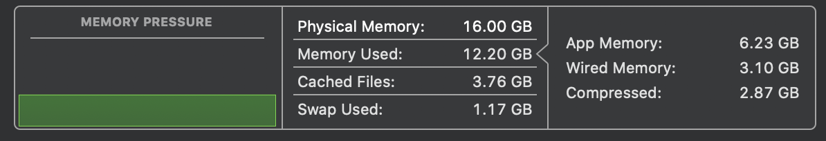

Did you use the Activity Monitor to see your RAM pressure:
You can use this guide from Apple to determine if more RAM would be appropriate for you:
Using many tabs on a browsers, gmail, MS (word, excel), always switching between apps, split screening.
You should be fine with 8GBs based on what you listed. Sometimes I deal with huge Excel spreadsheets that do a lot of calculations, and I very rarely go above 4GB of resources for Excel.
Memory is never as simple as "this single application I am using never exceeds X and if I have Y amount of RAM, which is greater than X, then Y amount of RAM is sufficient". Mac OS, just like any modern operating system, tries to use RAM as much as it can, even with no applications loaded, to cache files that are often used (Cached files in your activity monitor). These are usually your various system files which are accessed by the operating system constantly in the background. This speeds up your entire computer and makes it feel "snappy" to use. Of course you cannot keep everything in memory, unless you have a lot of it and are using a RAM drive, but I digress. This is why SSDs were the biggest change to our computers in the last decade in terms of day to day use, because they are so much faster than HDDs. Even in situations with low RAM, thrashing is not as noticeable as it was on computers with a mechanical HDD. Thrashing is when your computer is paging out constantly. RAM is much faster than the fastest SSDs. The answer to this is simple. RAM is cheap. 8 GB is not enough. It was not enough a few years ago and it is especially not enough with current versions of Mac OS. Upgrade to 16.
Having said all that.... I do have to wonder if OP is patching holes when the dam is about to break. I recently pulled out my old 2012 rMBP out of storage and upgraded it to Catalina and it is struggling, even with an SSD and 16 GBs of RAM.

Memory is never as simple as "this single application I am using never exceeds X and if I have Y amount of RAM, which is greater than X, then Y amount of RAM is sufficient". Mac OS, just like any modern operating system, tries to use RAM as much as it can, even with no applications loaded, to cache files that are often used (Cached files in your activity monitor). These are usually your various system files which are accessed by the operating system constantly in the background. This speeds up your entire computer and makes it feel "snappy" to use. Of course you cannot keep everything in memory, unless you have a lot of it and are using a RAM drive, but I digress. This is why SSDs were the biggest change to our computers in the last decade in terms of day to day use, because they are so much faster than HDDs. RAM is much faster than the fastest SSDs.
I know how RAM works. I was just giving a simple example of a resource heavy task and the amount of RAM being used for that app.
