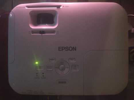

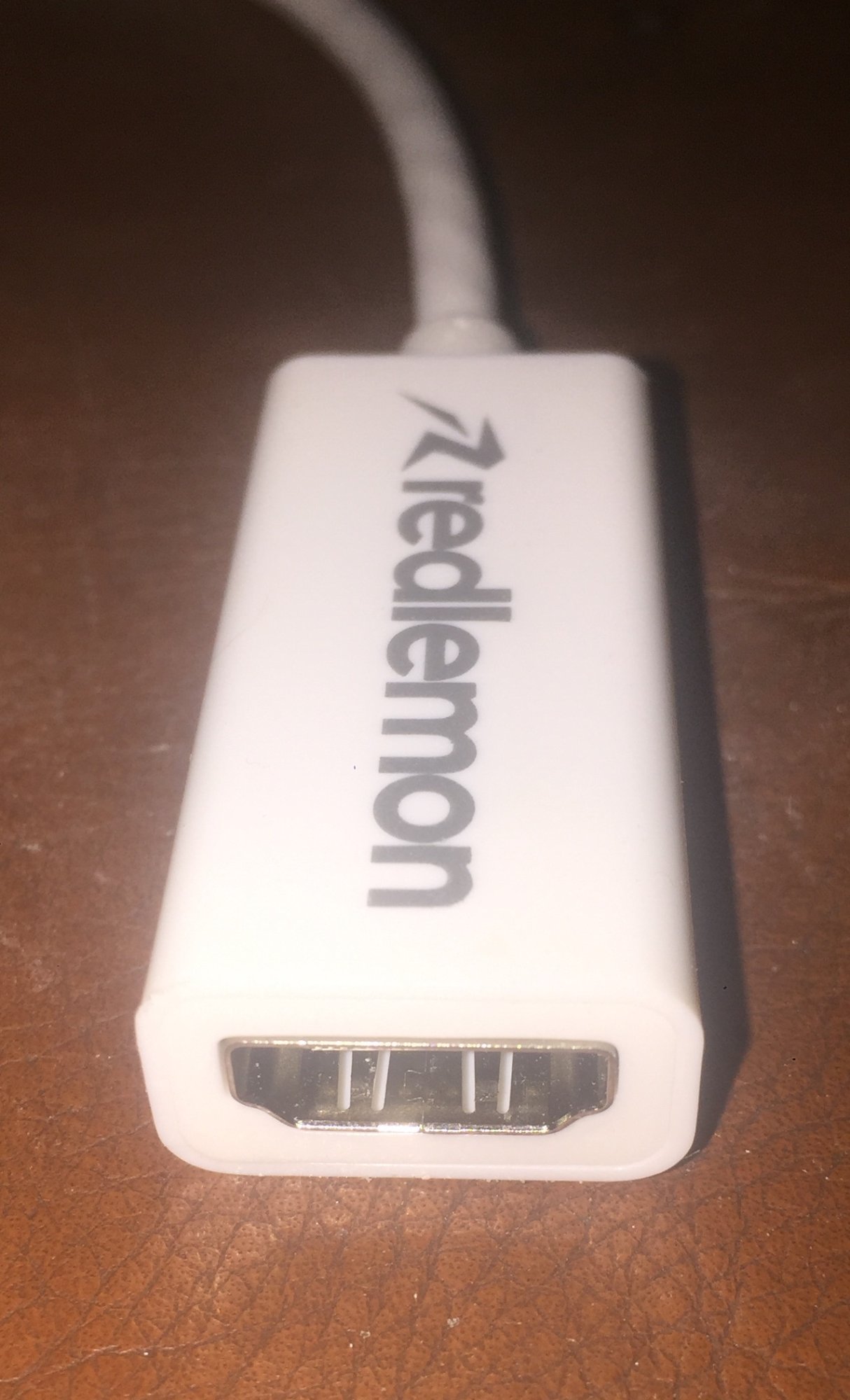

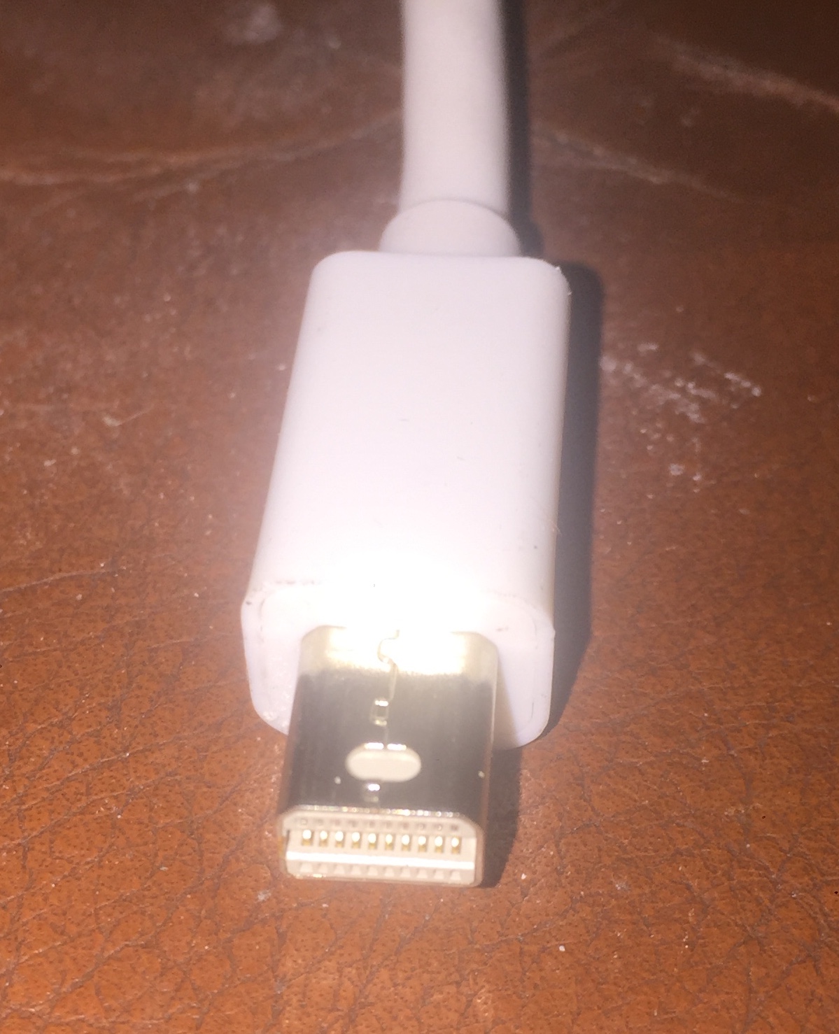

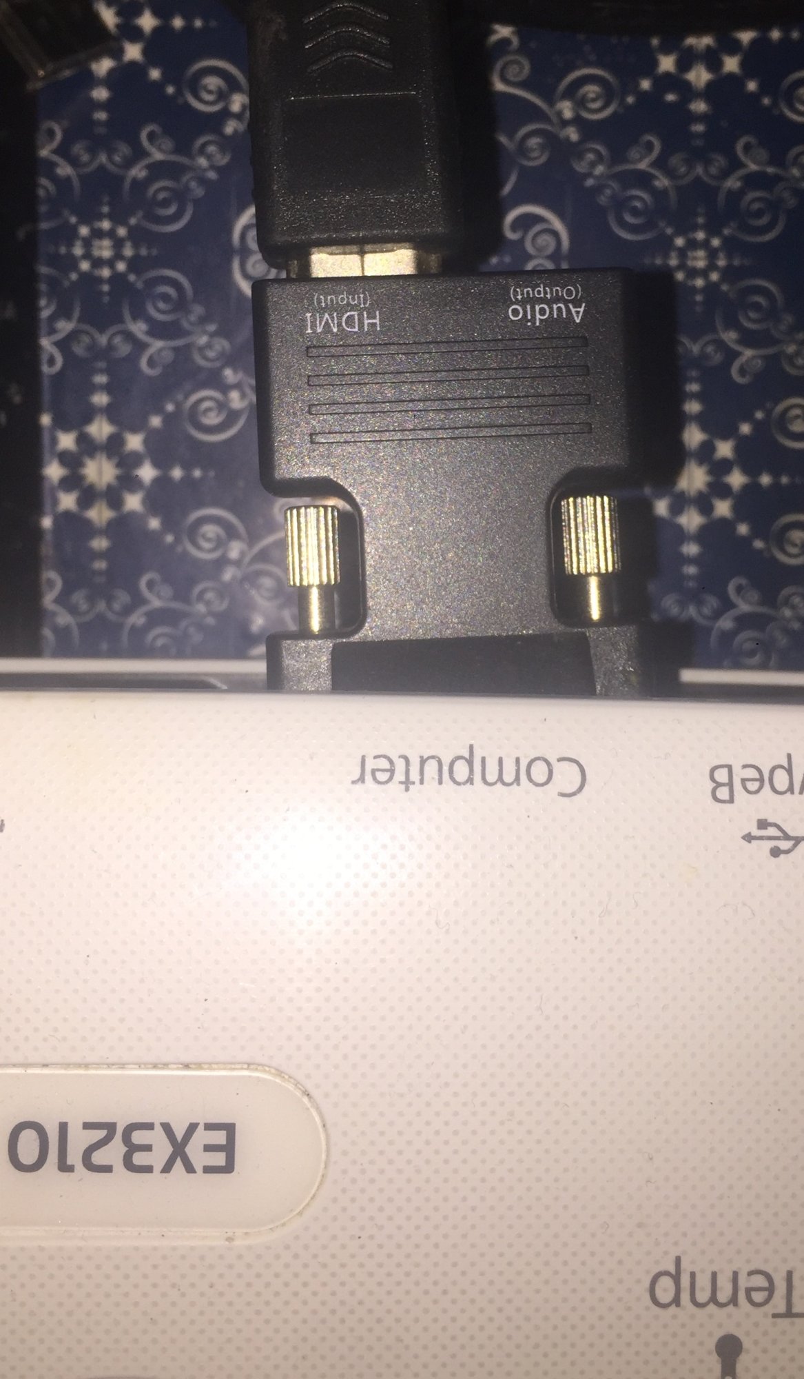

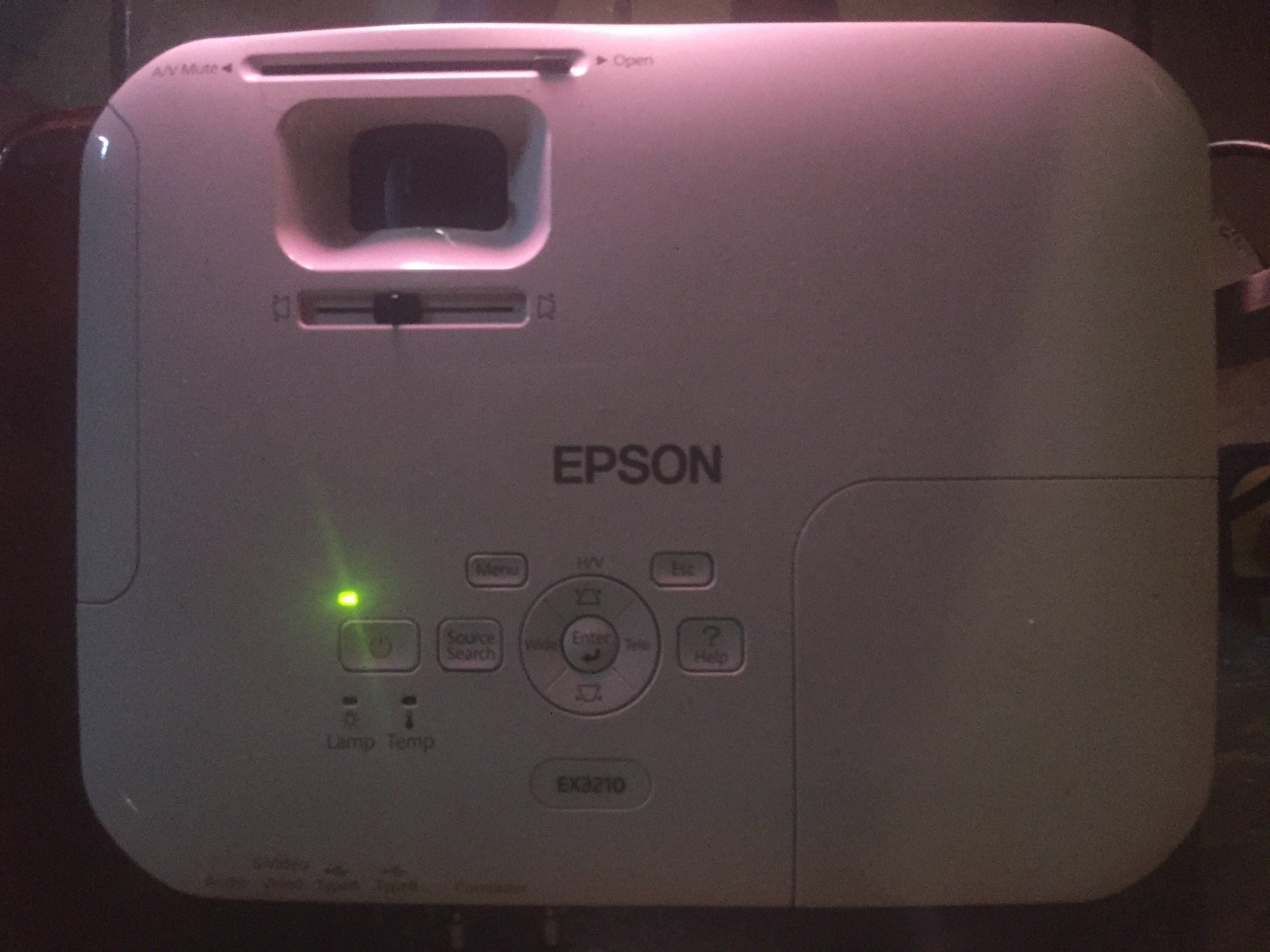

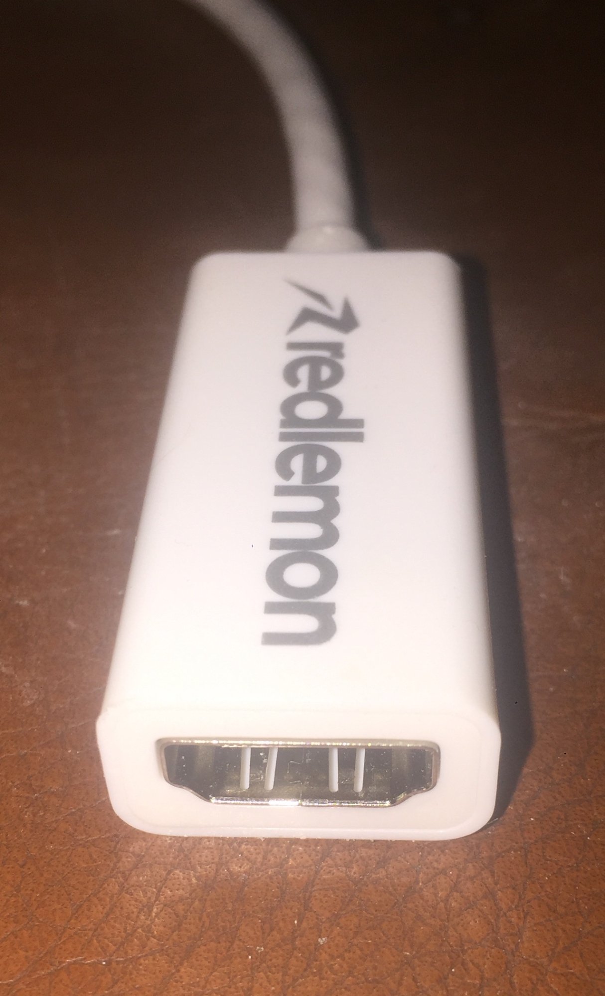

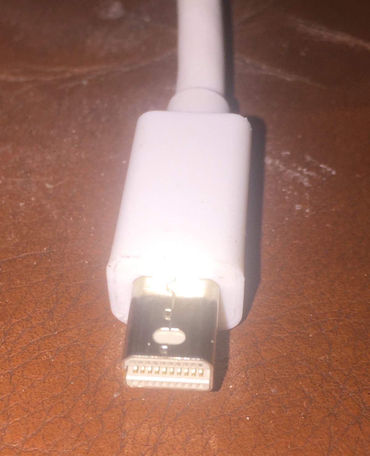

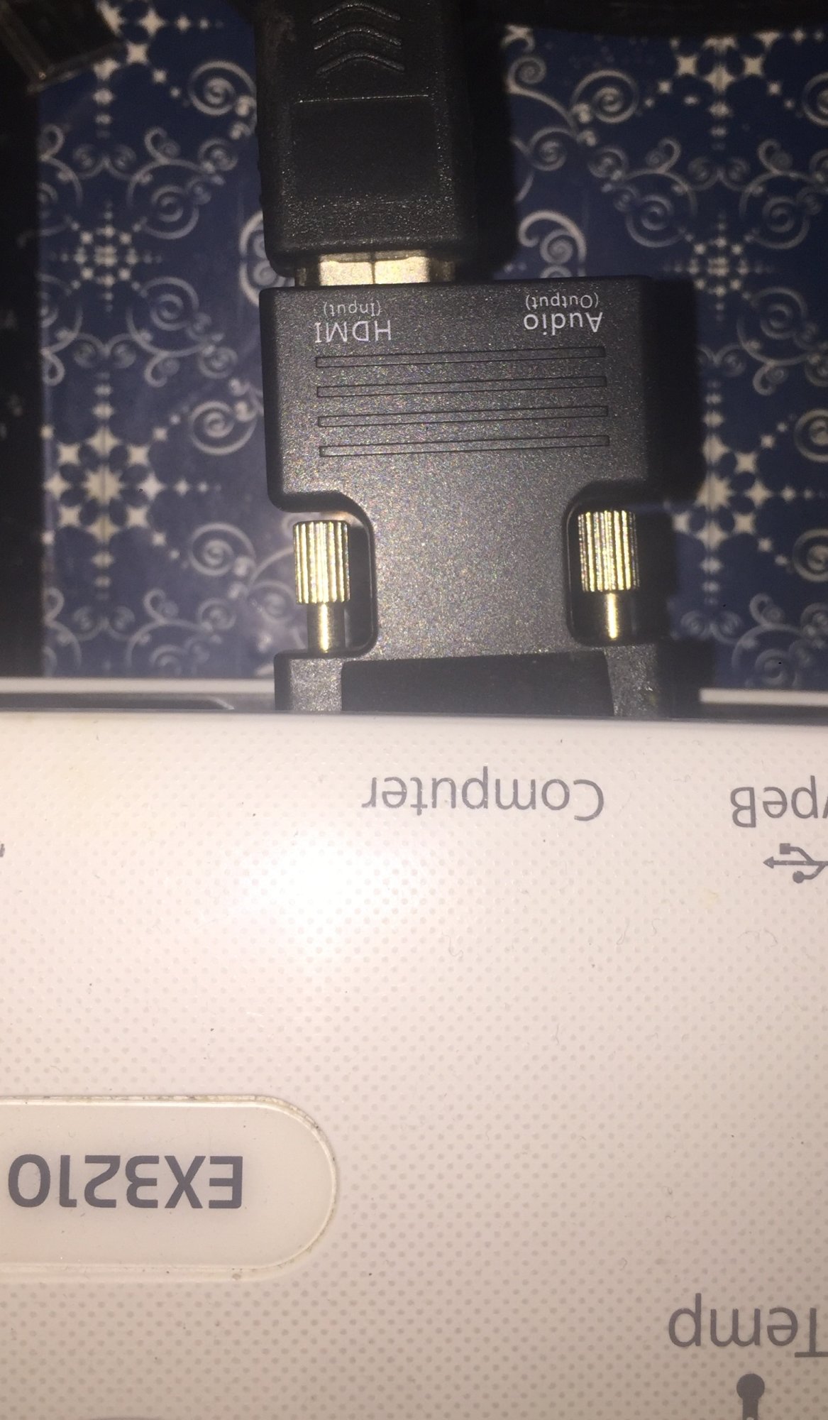

Hi,
So, I connected an adapter (mini DP to HDMi from the iMac thunderbolt port, the adapter connects to a good hdmi cable to a hdmi to VGA adapter to an Epson VGA port. Its a EX3210 projector without hdmi port, hence the adapter. Ive connected an android tv box or an Apple Tv box and it works fine. Thx Hieu!
Reactions: Nguyen Duc Hieu
Before you give up, try a different cable.
I would suggest eliminating the in-line adapters. Try a mDP to VGA cable, to connect directly from the iMac to the projector.
