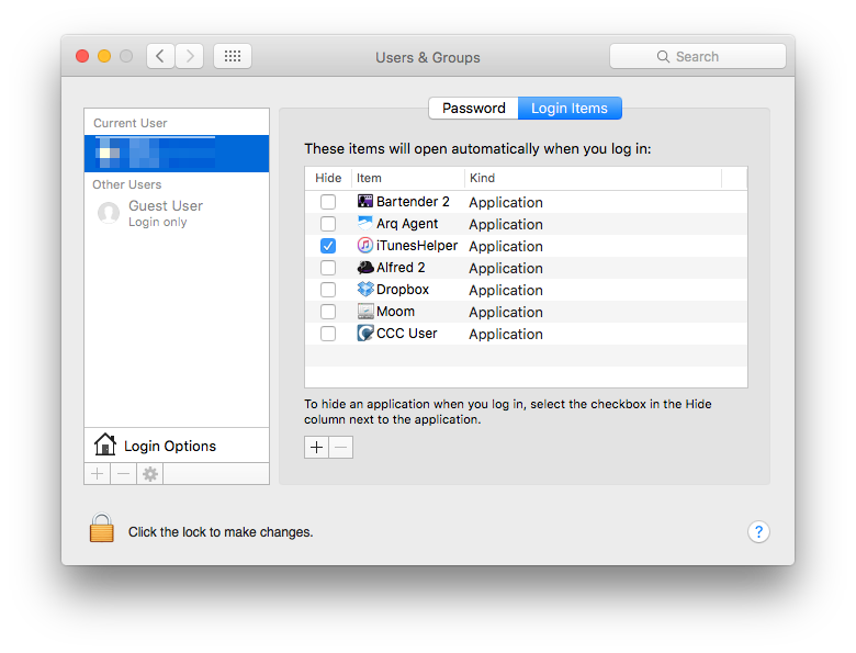

This is a good troubleshooting step. Safe mode stops all login and startup or launch items from running. So if it works fine in safe mode and not otherwise, that proves your issue is a conflict with a third party utility or app running at startup.
Those items are stored in the Users and Groups section for your account and also in the following folders. The ~ is your personal user account folder.

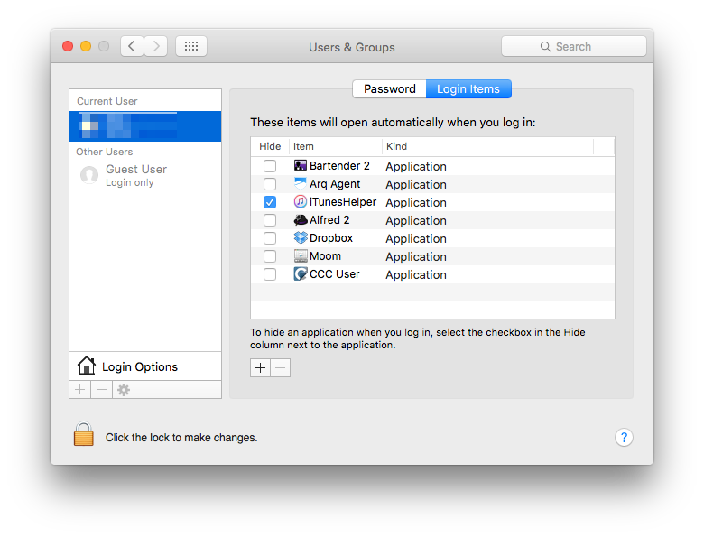

I thought that might be the case. Although my computer skills are limited, I thought that if I could start it in safe mode and it then runs OK, that there must be something loading at startup that was causing problems. This made me think the whole problem is software related and not my iMac dying.

I removed all I could find and the iMac was working for about a week and a half and then it started doing the same things (locked up with only the mouse pointer moving could not click on anything, would reboot in safe mode, then it might reboot normally but then only work for a short time and lock up again). I reloaded OSX and it worked for about 15 minutes and locked up again.
I'm a little confused the way you worded this.... so you still have these lockups but it never happens in safe mode... is that still the case??

Open System Preference then in the Users & Groups pane go to Login Items like in my screenshot and remove everything from there and give it a try. You can probably leave CCC there since it works fine for me under El Capitan.

Sorry about my poor wording. Yes, the lock ups only occur when I do a normal boot up. If it boots up, it will work fine for a few hours or so then the screen freezes and only the mouse pointer moves but I can't click on anything. I then hold the power button and force a shut down and re-boot into disc utility and do first aid on the drive and then it may or may not boot up. If it doesn't, I can do a safe boot and it boots up with safe boot and runs fine (but slower and with no sound). My other option is to boot into the recovery section and use disk utility and reload OSX.
Ok, do I just uncheck them or click on them and hit the minus sign so they completely go away?
Ok, I did that. I rebooted and it seems to be operating normally for the moment. I never know how long it will go for, but might I say that I think it may have even booted up a tad quicker. As this has happened before, I won't get too excited just yet but this does look good.
