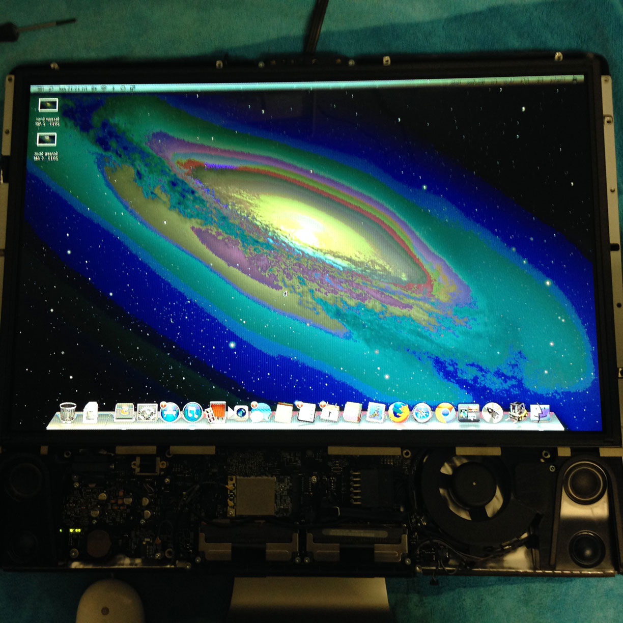

I just opened up my old iMac to replace the optical drive and now my screen looks like this...
Notice the low quality color.
I have reconnected the 4 inverter cables, the LCD fan sensor and the data cable.
The screenshots are perfectly clear indicating a LCD issue. Hopefully something silly.
Any ideas? Thanks for any help,.

OP, your LVDS cable might not be seated properly so I would reconnect that cable. If your screenshot is coming up properly, the issue is with the Display, LVDS Cable or logic board.
If I had to take a guess, you could have damaged the LVDS cable or the connector on the logic board side.

I was able test another LVDS cable with no success. My theory now is that there was some static electricity damage to a chip on the LCD during teardown.
I'll ask Apple what they suggest and what they can offer but it will likely not be worth the price. The imac is out of warranty. Maybe I can find a used working LCD on eBay.

In the end the problem wasnt even display related....
After the replacing the LCD with no results I swapped motherboard and voila.
Musta been the LVDS contact on the board or a short somewhere... A shame something probably small needed a full logic board replacement.
