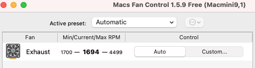

Yes, the fans spin all the time - just like my M1 Mini which spins at a low rate that I can't hear it.
My new M1 iMac is very quiet and I never hear it either.
M1 Mini fan:
Reactions: George Dawes
