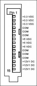

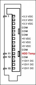

New hard drives that do not have the Apple logo are not compatible with the SATA standard introduced by Apple, which provides for a temperature sensor on the drive's electronics board. Apple drives use pin 11 of the SATA power connector (15-pin) to transfer power from the temperature sensor. The following explains the difference between the standard SATA connector and Apple's SATA connector:
Obrazek
Obrazek
Fig.
Figures 1 and 2 - Pinout of the SATA power connector (left standard pinout, right Apple pinout).
Solution:
Simply connect pin 11 to pin 12 of the SATA power connector with a drop of tin before installing the drive, as shown in the figures below:
