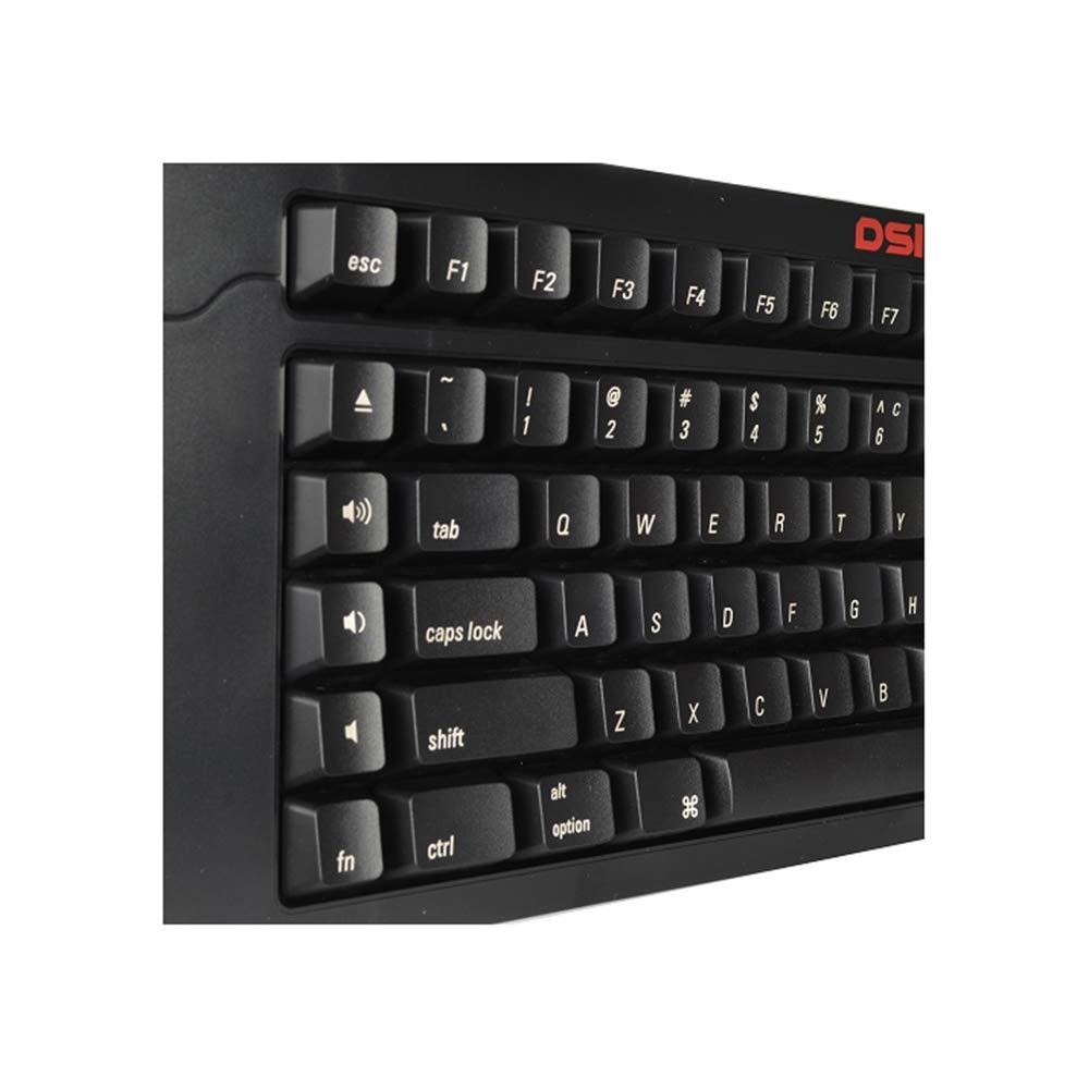

This is what I'm using.
It is different, and may take some getting used to. Brightness is controlled using the F14/F15 keys, for instance. Probably should bind some other key to use Expose.
https://www.amazon.com/gp/product/B00E6EIY90/ref=ppx_yo_dt_b_asin_title_o07_s00?ie=UTF8&psc=1
28 bucks for a Red Cherry MX keyboard...
It's USB 2.0, and has a hub built in.
