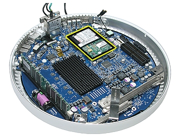

anyone seen one of these babys taken apart? i sure would like to get a gander at that mobo and see what everything looks like inside including that memory slot. If anyone has a picture of this please post it. I also would suggest not to screw up your warranty for anyone who still has one.
The modem card has a yellow outline. This is a picture taken from a Service Guide and the picture is showing where the modem card is. Also, this is from the new 1 GHz iMac.
