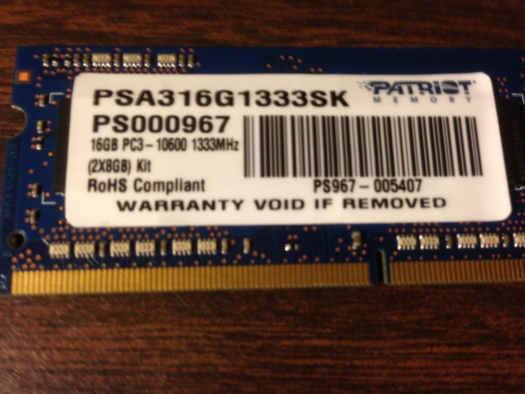

Very strange. Those appear to be 2 GB modules. What you purchased should have been a pair of 8GB modules though, so I'm at a loss. The only possibility I can think of is that somehow you got the wrong modules. You may want to try asking for replacements.
I think I will end up returning them, although they have the correct identification on them (2x8GB Kit). I've attached an image - you can make out the 2x8GB Kit lettering just above the RoHS Compliant.

Come to think of it, they probably don't let you use 8GB modules. Your model's maximum capacity is 16GB as advertised by Apple. It's possible it has problems with 8GB modules. You may want to try 4x4GB. I'd call Apple to verify. They'd know better than I would.
Yes, the official line is that this model doesn't support more than 16gb total or 8gb modules, but there are a number of reports from users that they have installed 8gb modules and as much as 32gb of memory. For example: https://discussions.apple.com/thread/4241780?tstart=0 (I added my problem into this thread also, but didn't get any useful responses)
Anyway, I did return the modules. Pricewise, the 4gb modules are not very good deals, so I'll just stick with the 8gb I have for now.
