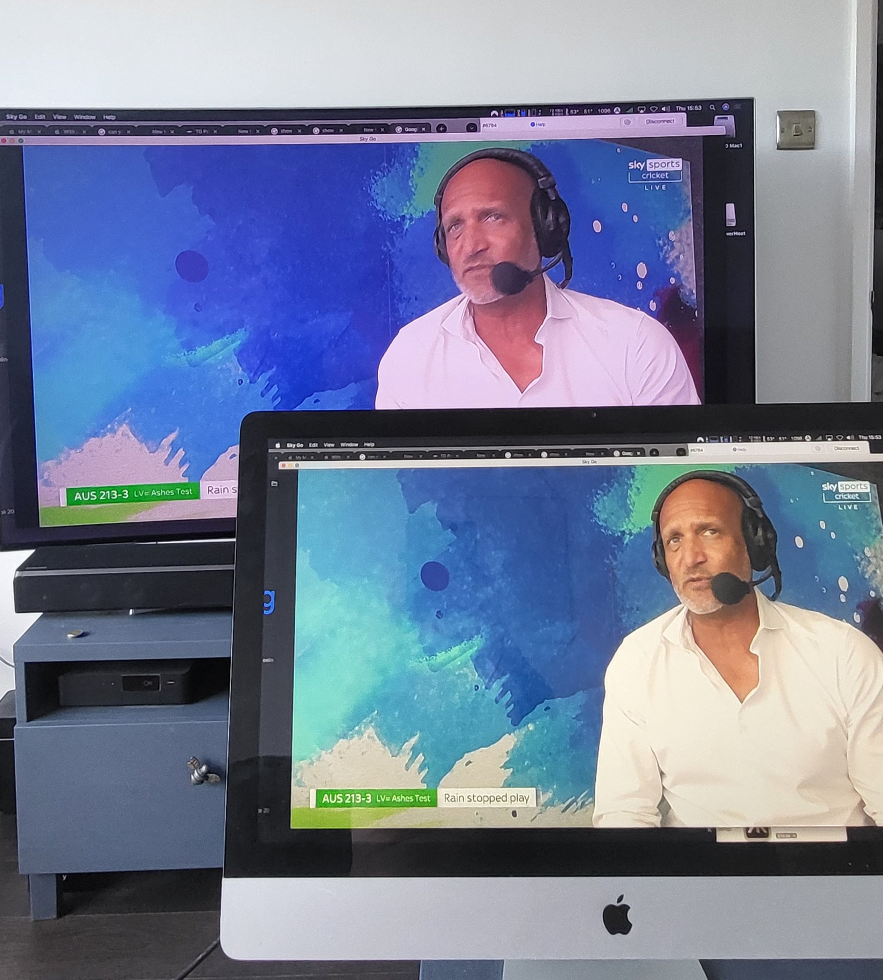

Whilst the 30 inch max output is spelled out repeatedly by apple - Ive now tested on two new cables £6.50 each and .. it works - 32inch full display ahd at full resolution 1080p, not tried 4k Yet, but great start!
Reactions: Nguyen Duc Hieu
Works on 65 inch also... At 1080p but the adaptor I purchased is 1080p only there is a 4k veriosion so. May try that also?
But all working

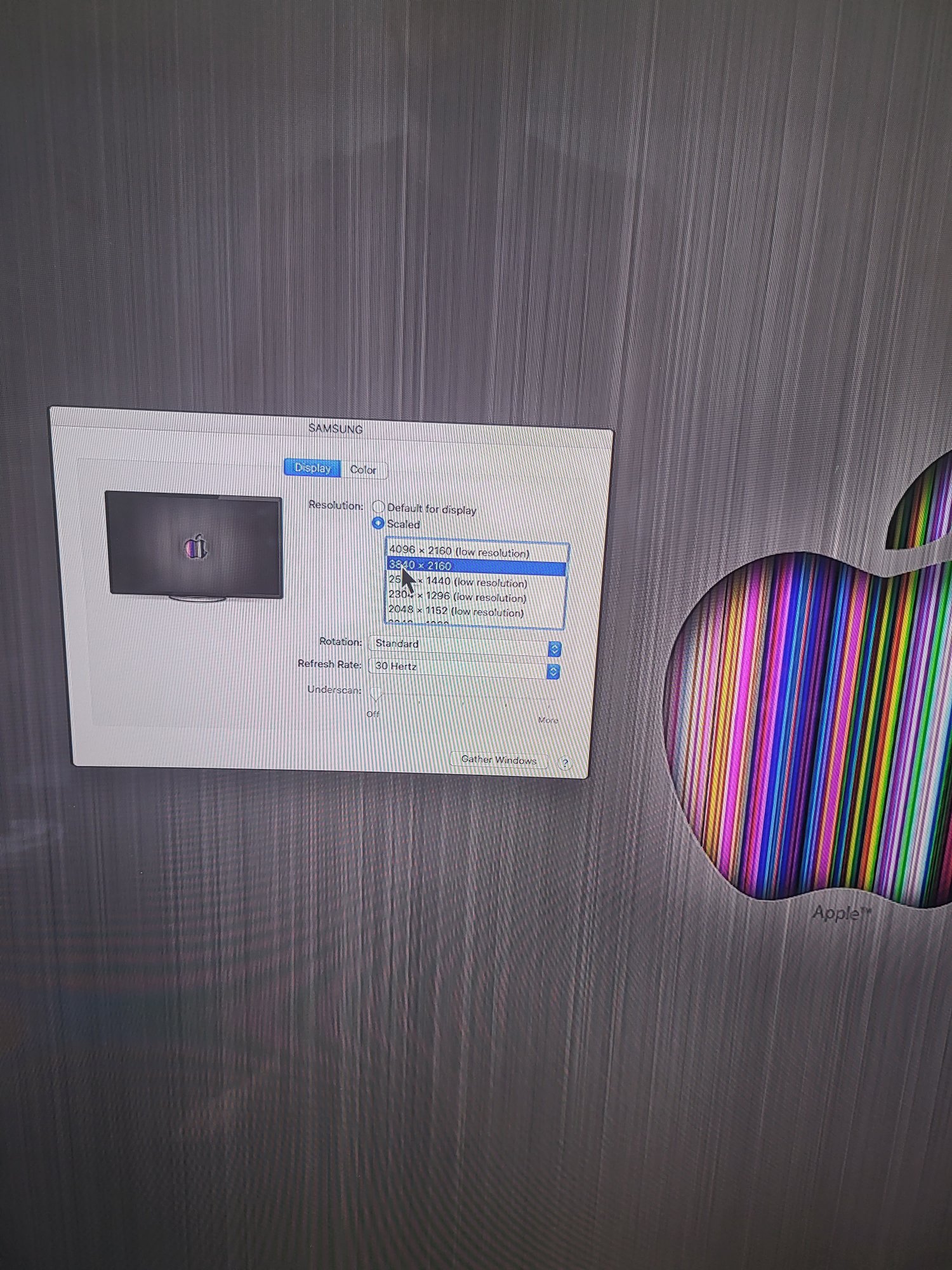

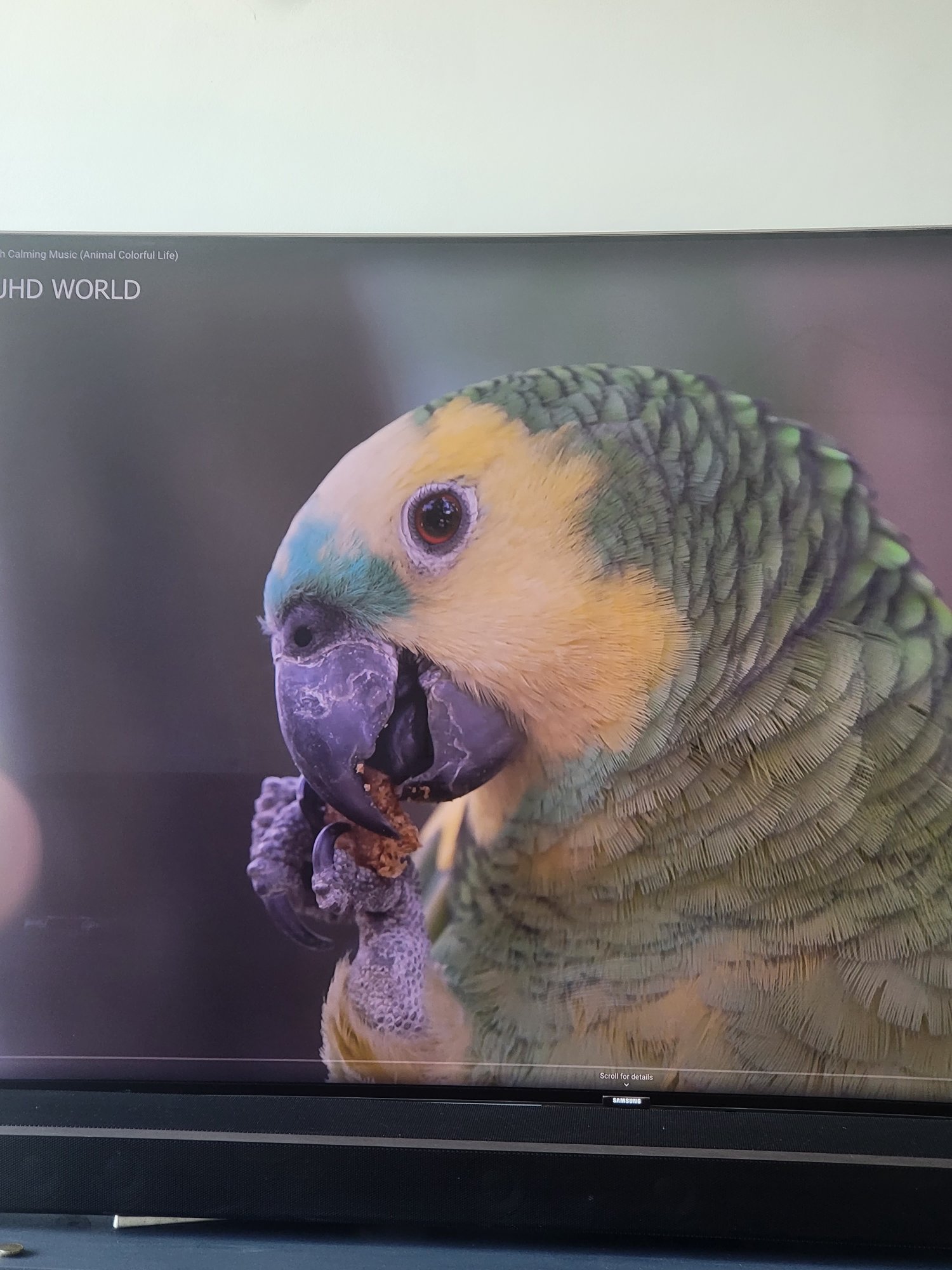

Adaptor 2 4k max
- The hdmi adaptor that can transmit 4k...first try, did only 1080p also 1920 x 1080 and gave me no 9ther options, underscan or to alter htz.
- I then unplugged and switched back to Adaptor 1, I then switched again back to adaptor 2 and suddenly a whole load of new resolution options came up (some stating low. Resolution next to them) but with real High pixel density. (see picture)
-highest low res is 4096 x 2160 (higher thelan 4k)
- highest full res is 3840 x 2160 (4k) very little diff in quality to the above but screen fit is perfrct (4096 sent image off screen very slightly )
So the AMD RADEON HD 6770M 512 MB can transmit 4k it seems.. and more...
Did notice when in 1080p 60hz was useable but the 4k and higher maxed out at 30hz. (someone might be able to explain this to me and the impact or why)
But.. All a images picture sharp.
