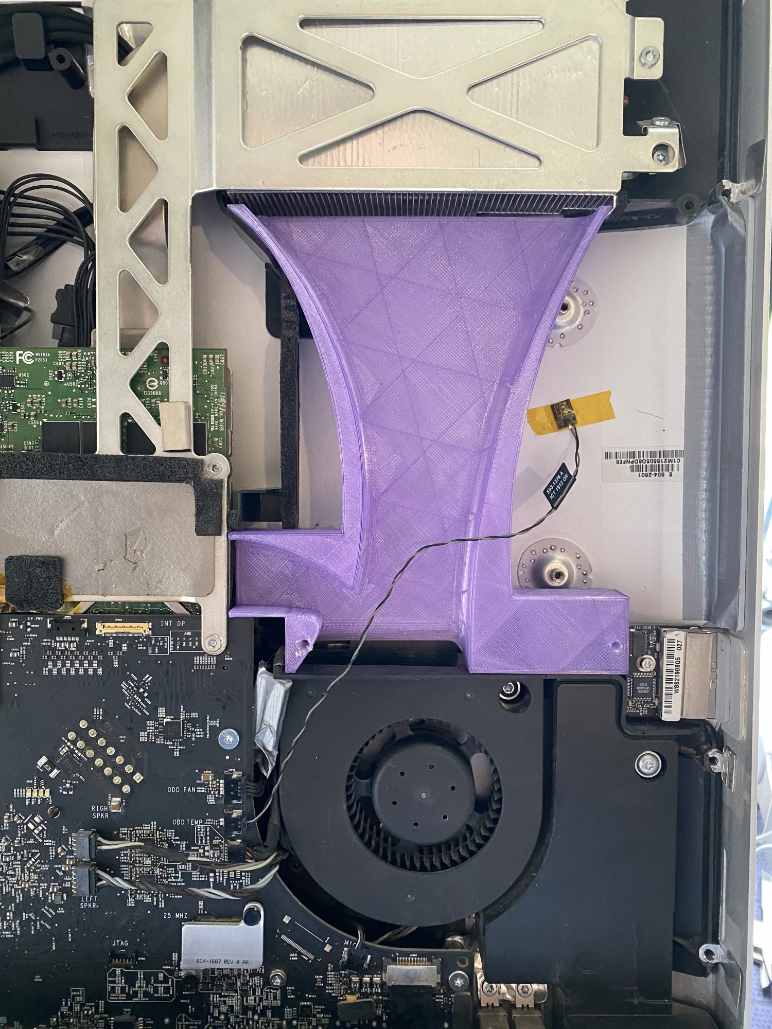

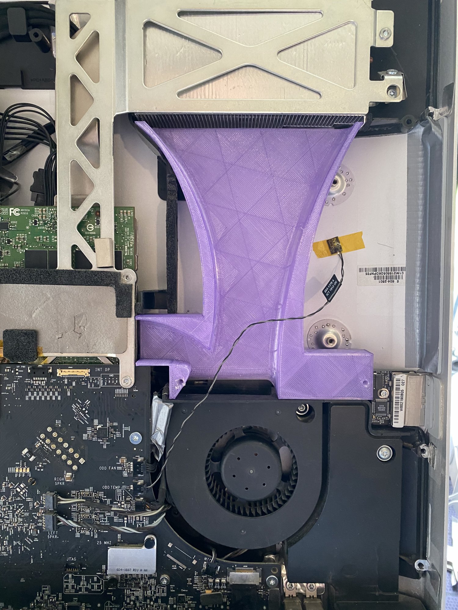

I did my upgrade, but felt it was getting to hot so I made this little fan guide.. testing at the mo..
