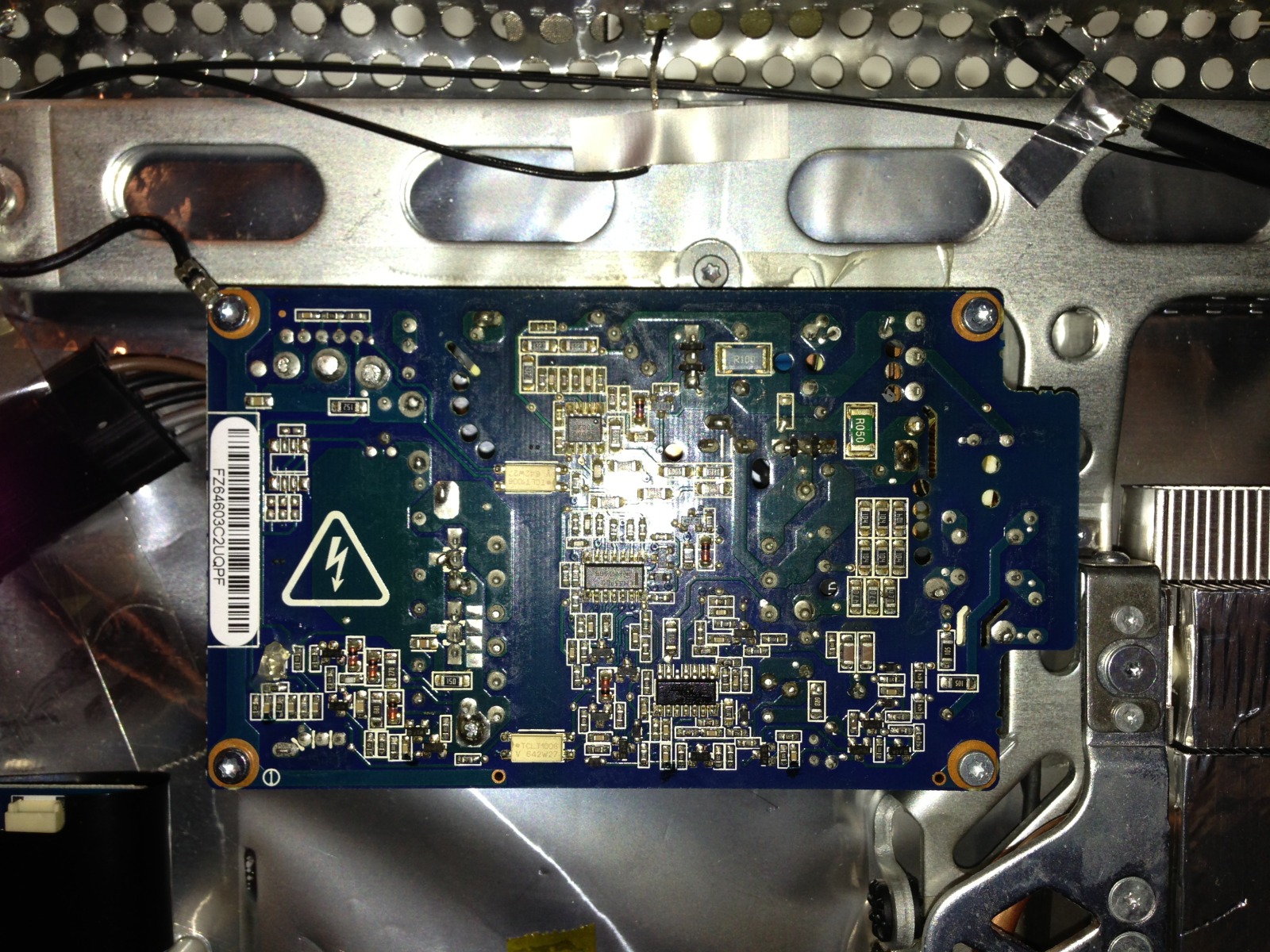

I just plugged it in to see if maybe it would revive and the PSU sparked big time. It actually was one large bright spark accompanied by a large POP. Now the room smells of smoke and the PSU has turned brown in some spots.
I really, really hope this didn't zap the logic board.
If you touched the metal it normally will equalise the voltage, so this might not be the problem here, you might have moved something and it short circuited.
Hard to tell, the photo is with flash, can't see much there.

Sorry about the photo; the non-flash version did not show well either. The top-middle portion of the PSU (as well as the tape strip above it) turned a bit brown.
I guess I messed it up but I thought I took all the right precautions. I've repaired the same exact computer before (and many others) so I did not see that coming.
