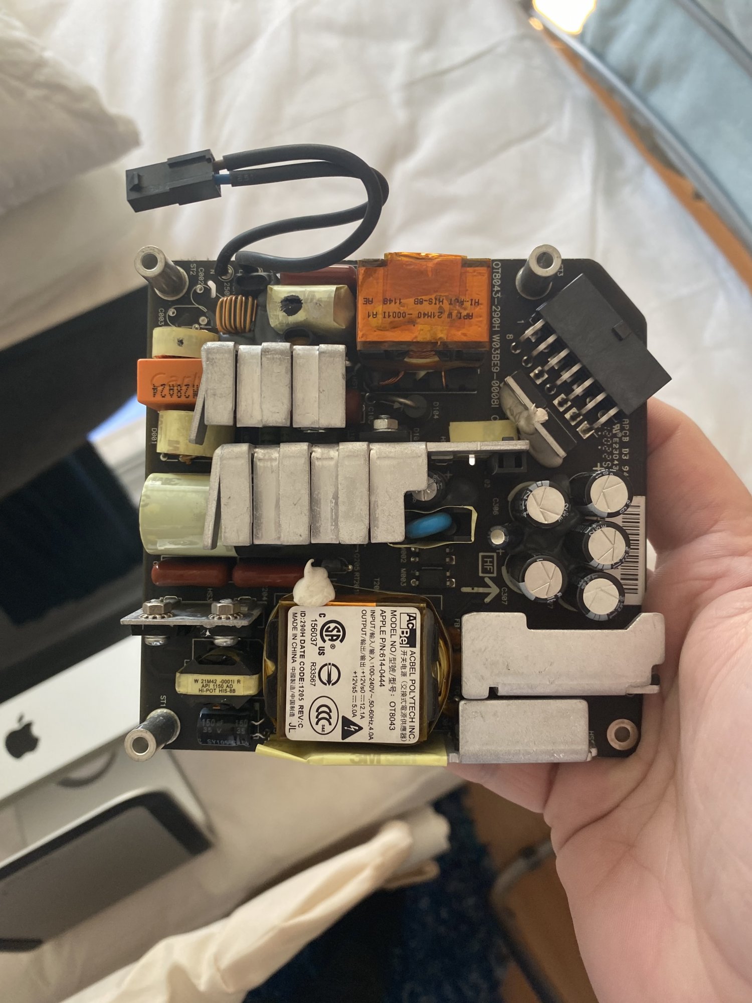

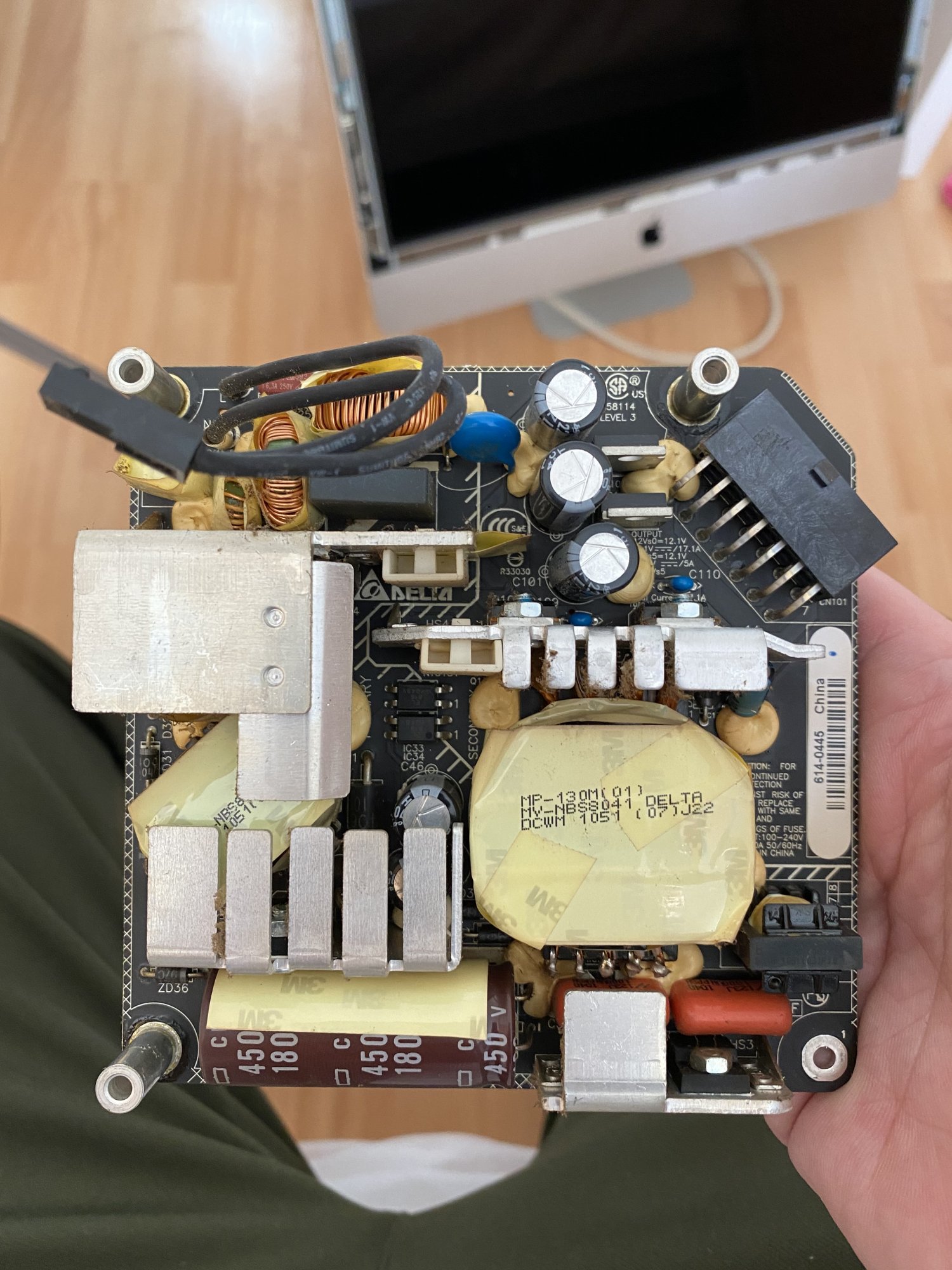

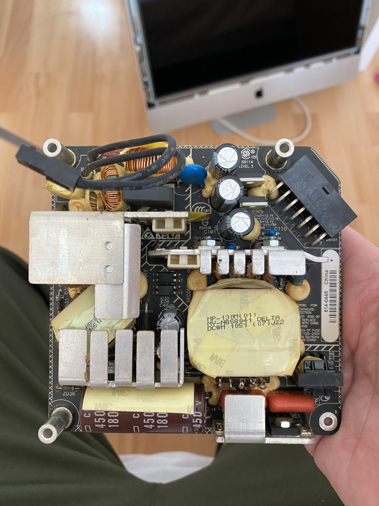

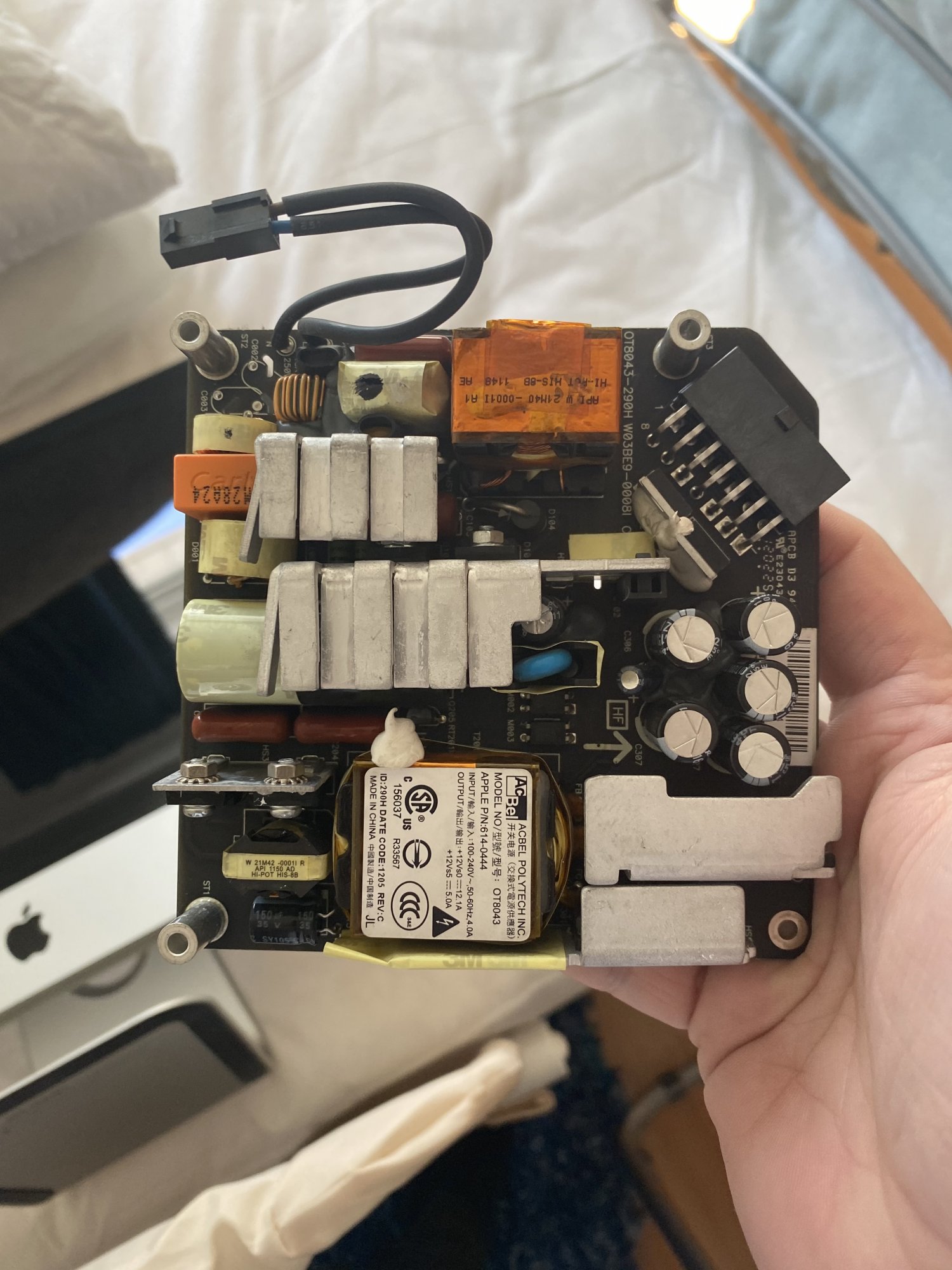

Failed,
[automerge]1586190474[/automerge]
this is what came out...
[automerge]1586190543[/automerge]
this is what came, put it in and the fan was constantly whiring, would this is because its not exactly looking the same ?

so we have life, had to replace the ribbon to the lcd. just wondering why the fan noise is constantly spinning at full rpm? could this be to the fact of a different variation of replacement power unit, even though it was suggested this one would be fine?
cheers.
