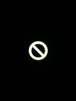

I just got latest iMac and tried boot from my old laptop ssd via USB dock and all i get is grey screen with error sign. Same ssd boots just fine with two laptops, but not with iMac.
I tried also boot from usb installer but get same error. Any ideas? I have never seen that error before.

Booting from an external device ( such as USB stick ) will trigger the password prompt if the iMac's firmware password is set but your screen shot doesn't show that prompt. Have you tried booting with the OPTION key held down? Presumably results will be the same but if it shows boot drives it could be a clue.

OS in SSD is 10.11 same as in iMac. If i boot with option-key i can see the ssd as boot option, but when i click it i get that error screen. It never advances to the point where password is entered.
It does the same with 10.11 installer USB stick. So i could not even do clean install if i wanted.
