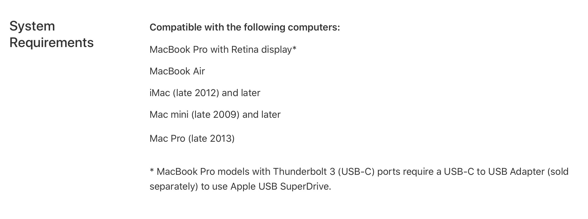

The Apple external Superdrive does not support older Macs. Unfortunately the 2011 iMac is not on the list.
Here are the the System Requirements for it;
I bought one to support a 2014 Mac mini in 2015 and it worked fine. As an experiment, I attached it to a 2011 MBP to see if it would work and sure enough it would not work.
I thought the Apple external Superdrive was overpriced and too limited for Mac support.
