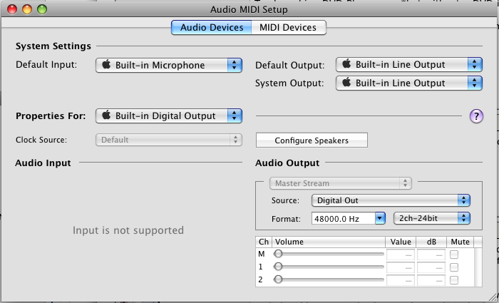

Well, that is strange. Your iMac thinks it's sending out optical audio and your receiver decodes DD from your MBP...
Try opening Audio Midi Setup in your Utilities folder and set the DigOut frequency to 48khz as below. Does that change anything?

Just tried what both of you suggested, and nothing worked !
