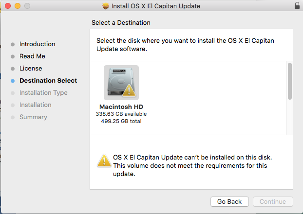

Apparently can't do "combo" update for some reason.?
OS X El Capitan Update can't be installed on this disk. This volume does not meet the requirem...png
Yes, what chrfr said makes sense.
OP...
If you don't want to try the USB/ethernet alternative, seems like your only choices at this point are to
- go backward -- wipe the drive and re-install "up to the combo update" (if that's even possible), but then "go no further"
or
- go forward -- I'd suggest trying 10.12 "Low Sierra".
Do you have an EXTERNAL USB3 drive? Use that as your "test platform" for either of the above approaches.
That way, you can experiment without "touching" your existing internal drive.
