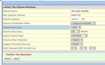

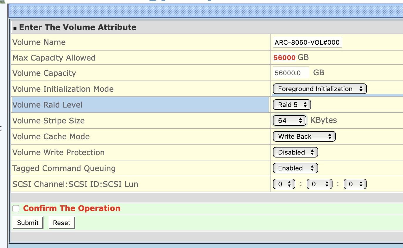

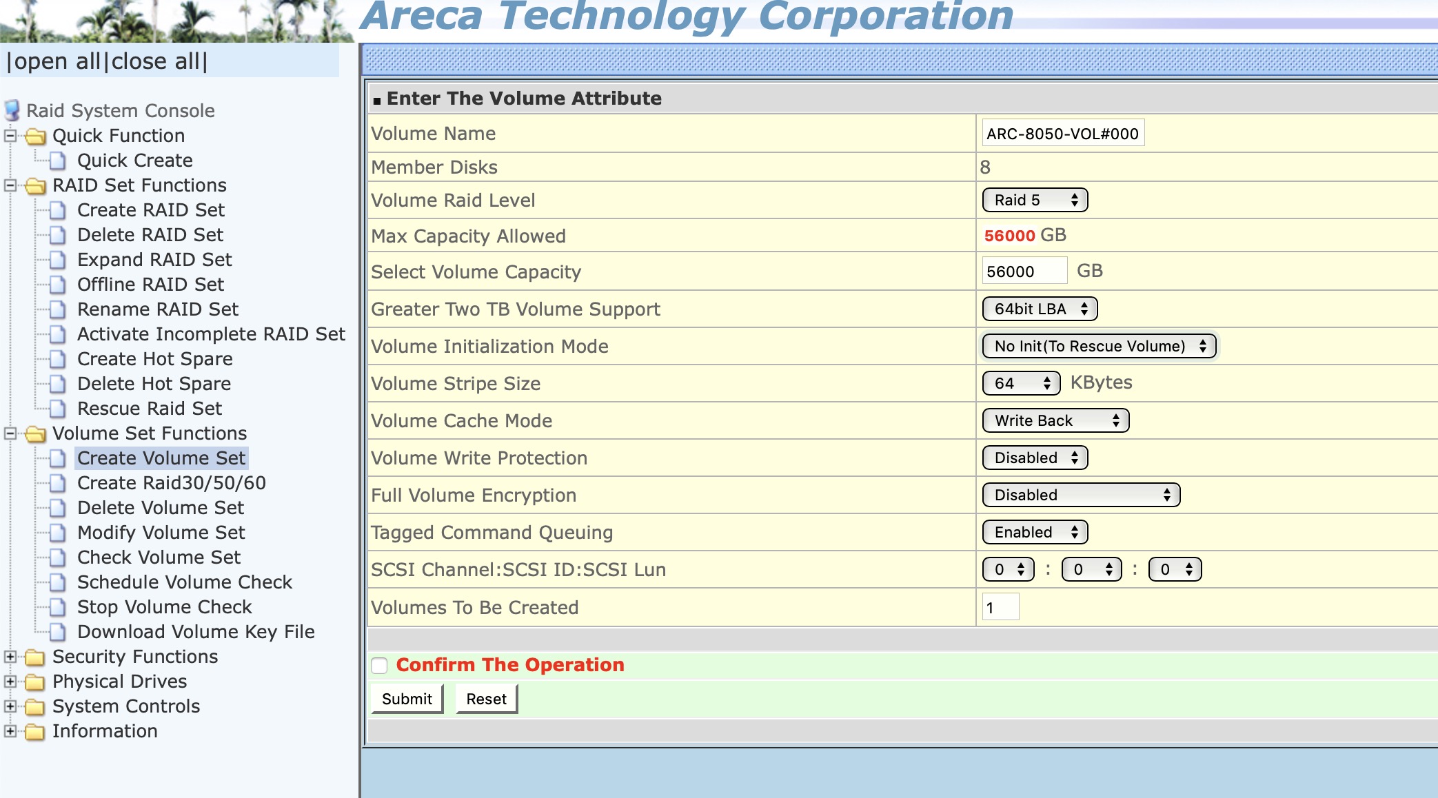

To streamline Data and get some room we built up a Areca ARC-8050T3-8 Bay TB3 RAID with 8 x 8 TB (64 TB) WDC WD80EFAX as RAID 5 (Net 56 GB). The Areca comes with a Areca TB 3 Cable.

- After the usual Bad Block Initializing (takes about 8 hrs)
- and formatting the Volume the Areca was there for the first time

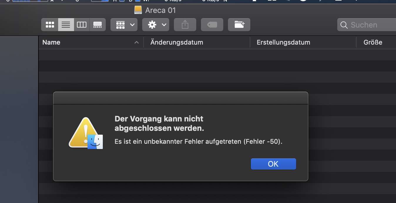

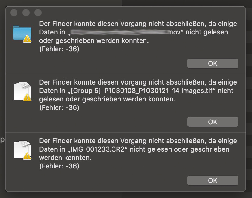

But when we started testing, copying a 100 GB Folder with files, Finder Stopped with Error -36 and -50 after about 30 Secs. Restart etc etc. We tried again.
After about 10 minutes or whatever for 800 GB transfer finder stopped after about 600 GB with Error -36. After this if you would access the Areca it was Error -50. (the Areca has a HTTP Interface, so it can be accessed via WebInterface from there as well, even if Finder has hung up or shows the -50 Error).

Just to make sure we did everything right, we wiped the Areca, initialized over night etc etc.
Then test again. Same errors, after about 500 GB transfer, time finder stopped with Error -36, Error -50. Then the Areca was not visible anymore in Finder (but in Terminal via Diskutil etc).

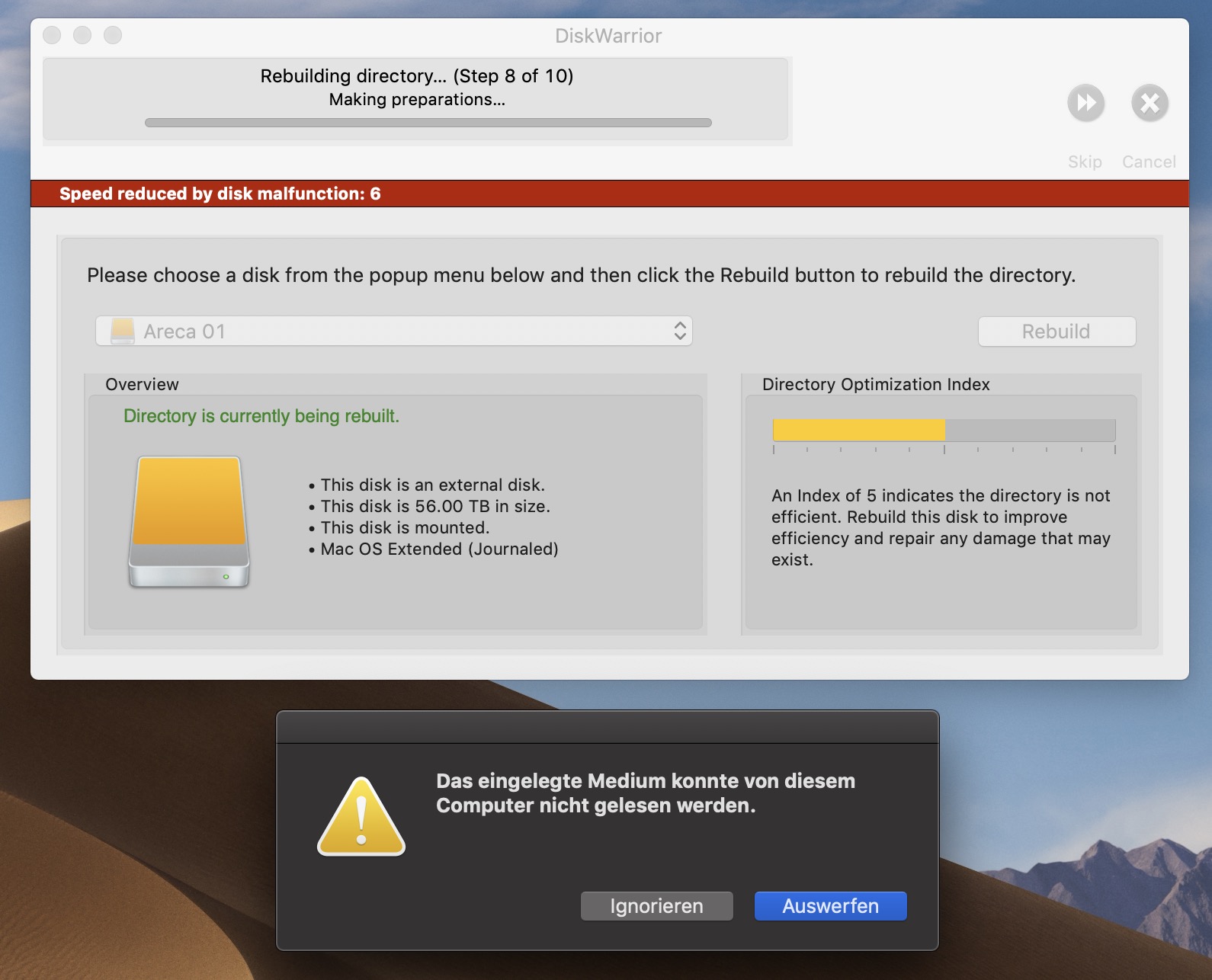

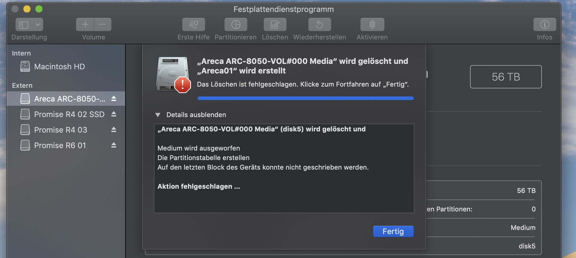

We have got all sorts of errors in between, see screenshots.

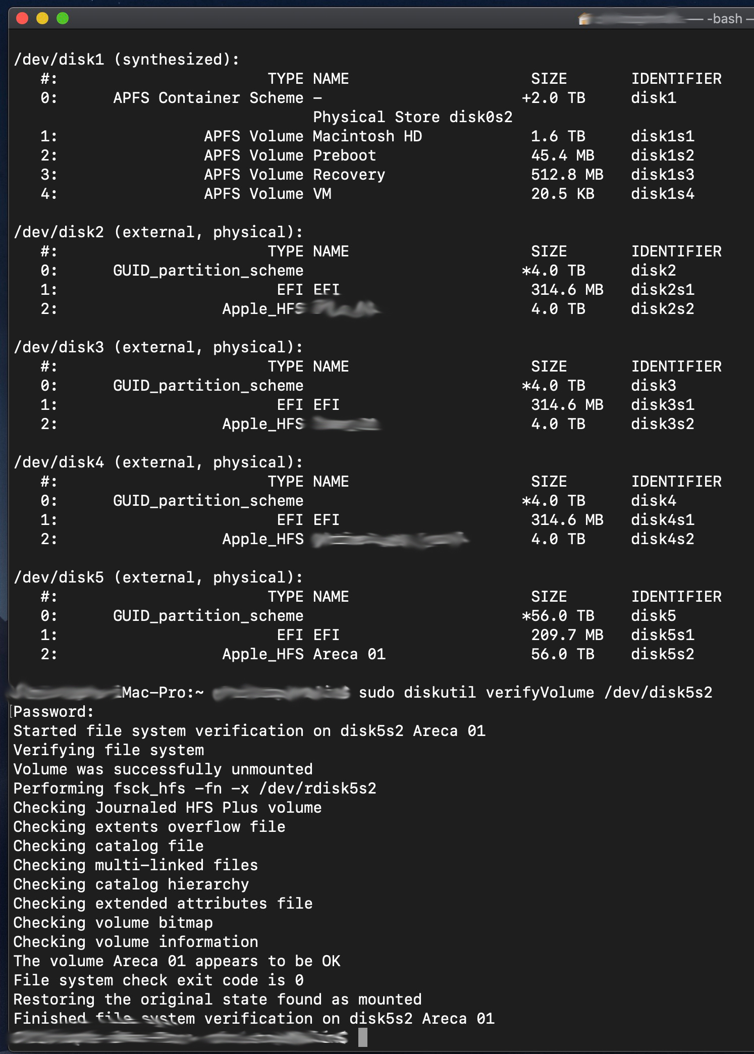

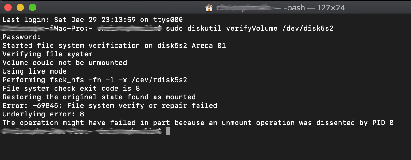

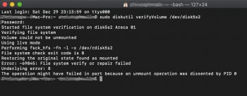

The two Diskutil Terminal Shots are taken before Copy starts, and after Finder error 36 and 50. First the Areca is there, then after Error 50 etc it doesn't let unmount.
Any Ideas? Did we forget something.
Look in the system logs for any additional messages regarding these errors. -36 and -50 appear to be rather generic error messages. Perhaps the german localization was incomplete?
paramErr = -50, /*error in user parameter list*/
ioErr = -36, /*I/O error (bummers)*/
source.
