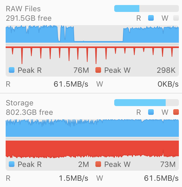

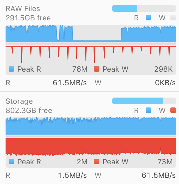

Not sure how helpful this will be, but I just did a test copy of about 45gb, from a Thunderbolt drive to a USB3 drive. The operation completed in about 10-11 minutes, speed was around 60-70MB/s. I did, however, notice one peculiarity. After about 5 minutes, the READ speed reported by iStat Menus for the Thunderbolt drive dropped to about 3-5MB/s, and stayed that way for about the next 3 minutes, before going back up to 60-70MB/s. The strange part was that even during this reported read speed drop, the WRITE speed on the USB3 drive continued to show 60-70MB/s and the Finder's time estimate did not grow. Also, the activity light for the Thunderbolt drive continued to flicker at about the same level during the reported speed drop as it did when the reported speed was normal. That leads me to believe that iStat Menu's indication of a read speed drop was not real.

Thunderbolt drive is the top one, USB3 on bottom... note the big drop in the Thunderbolt drive's read speed roughly halfway through, while the write speed of the USB3 drive remains fairly constant.
