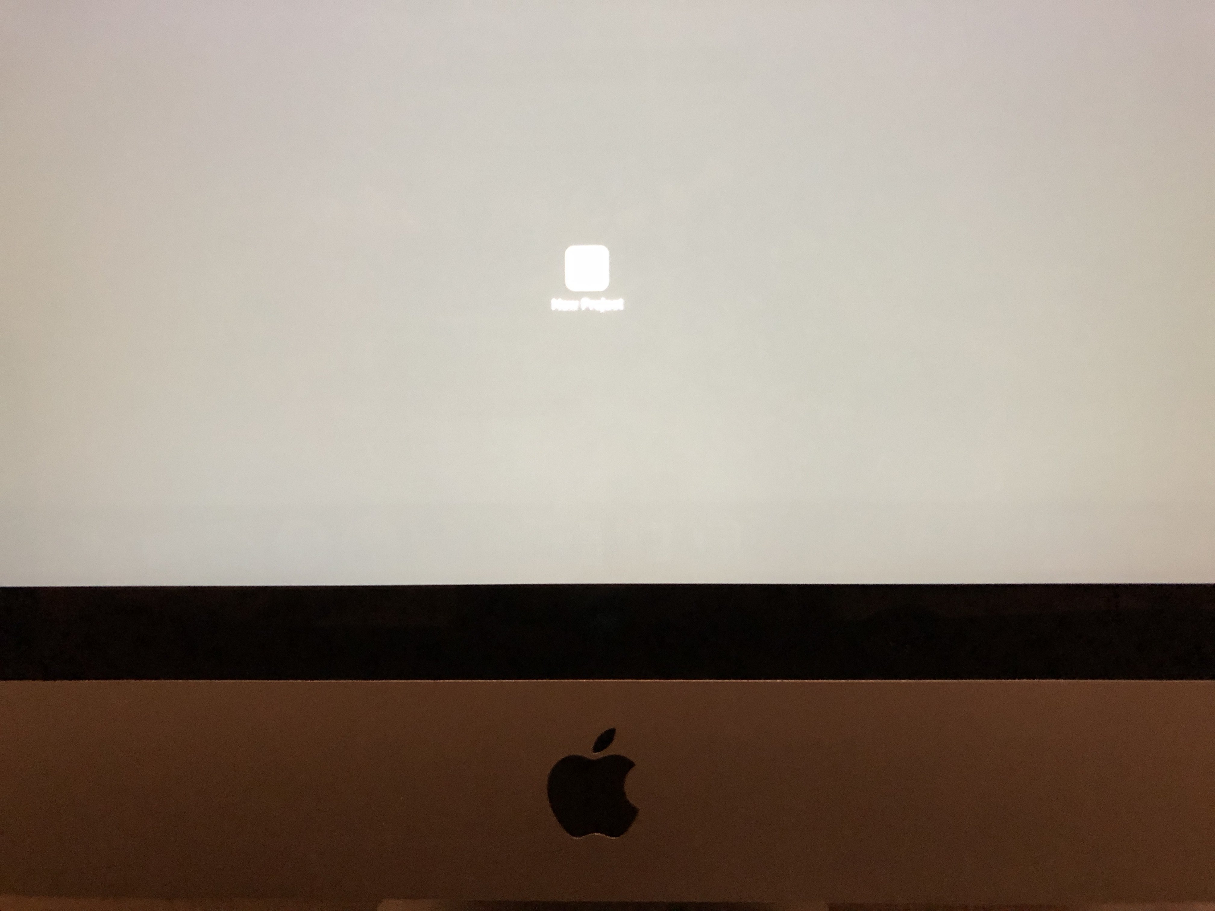

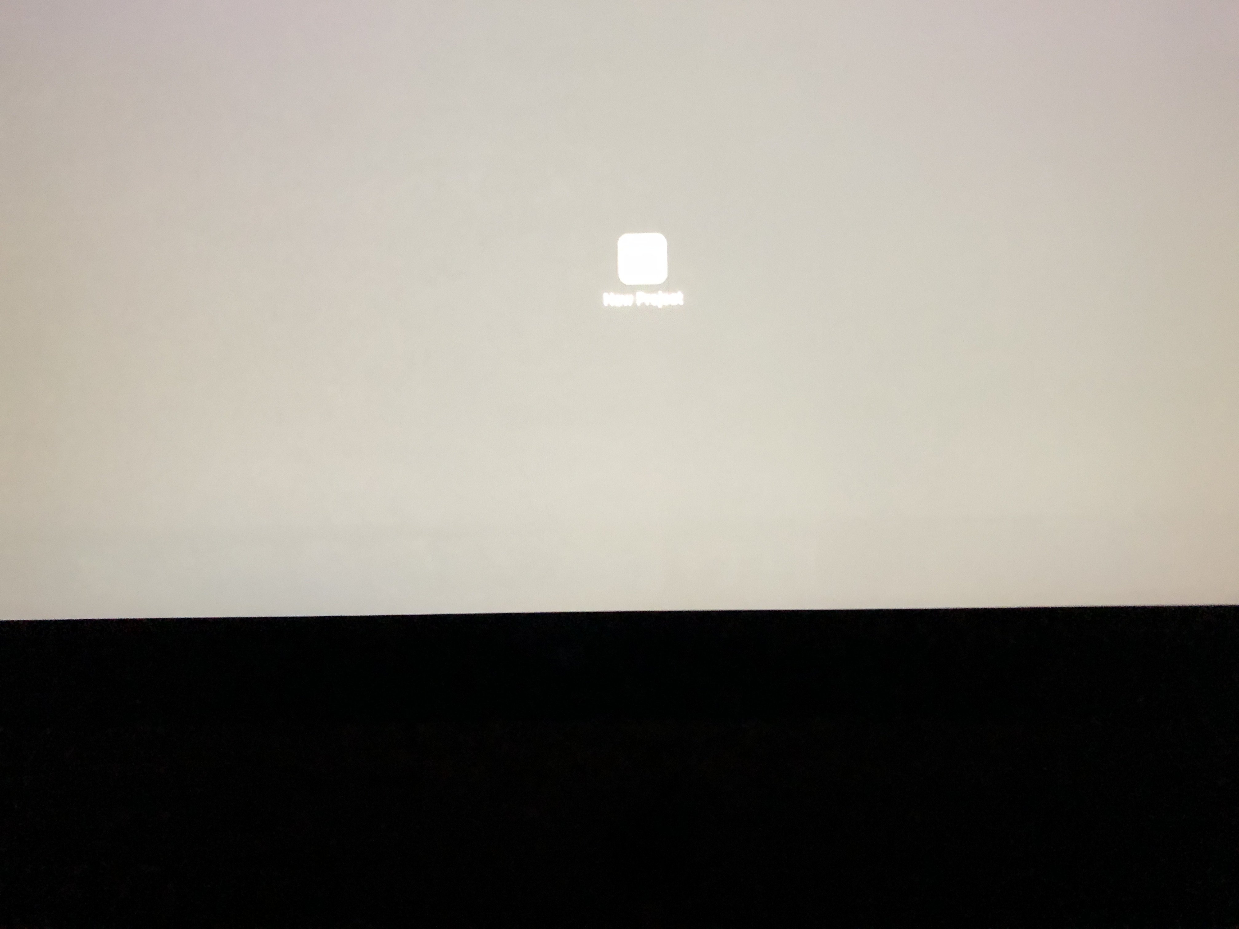

Is it an inherent flaw that all LG panels dating back from late 2012 iMacs to the new models including the iMac Pro all suffer image retention/persistence/ghosting? I noticed my late 2012 iMac 27", returned iMac Pro, and current iMac Pro with upgraded RAM seem to all be affected. I can easily reproduce small signs of this from normal usage from simply browsing the web for 5 minutes or more with my dock shown and shortly spot very subtle outlines of my dock icons at the bottom after opening Final Cut Pro in full screen mode.
I have found multiple users experiencing the same issue on other iMac models online and I just want to know if this is normal to have. I want to get a definitive answer as I keep finding mixed answers with some stating its normal and apart of the technology, while others reporting it a defect that shouldn't happen. I'm worried later down the line the ghosting effects will get worse and I would hate to have to visit the Apple Store for this issue so soon, especially after spending over $8,000.
Only had the machine for 1 week.
That doesn't seem normal and as such, I'd take it back.
I've had my iMac since 2015 and I've not had any IR
It does seem that your iMac displays the logon screen for periods of time, is there anything you can do to mitigate the risk? I'm not blaming you, but if there are steps you can take to minimize the risk, then I recommend such actions.
I could hide the menu bar and dock to mitigate this issue, but I rather not as the animation delays would slow down my work.
I was thinking of that big spot in the middle that I presume is your login screen.
That is actually the Final Cut Pro screen with the "New Project" box. The IR I'm referring to is the very very subtle blurs on the bottom of the gray screen when opening FCP.
You would probably be more likely to mitigate this in picture settings so playing with things like brightness or contrast could have a good impact on this. Like you said you already returned a iMac pro that had similar behavior. I do have a LG 5k that has some IR as well so I think this is just part of them cranking out so much brightness on these. The IR didn't really bug me all that much in normal usage but I did notice it from time to time on backgrounds. May not have to be huge differences either like if the contrast is pegged at max back it off a little bit and see if that helps any. A lot of times with TV's they put them into torch mode so they look good compared to everything else so you may have some room on the settings to adjust things.

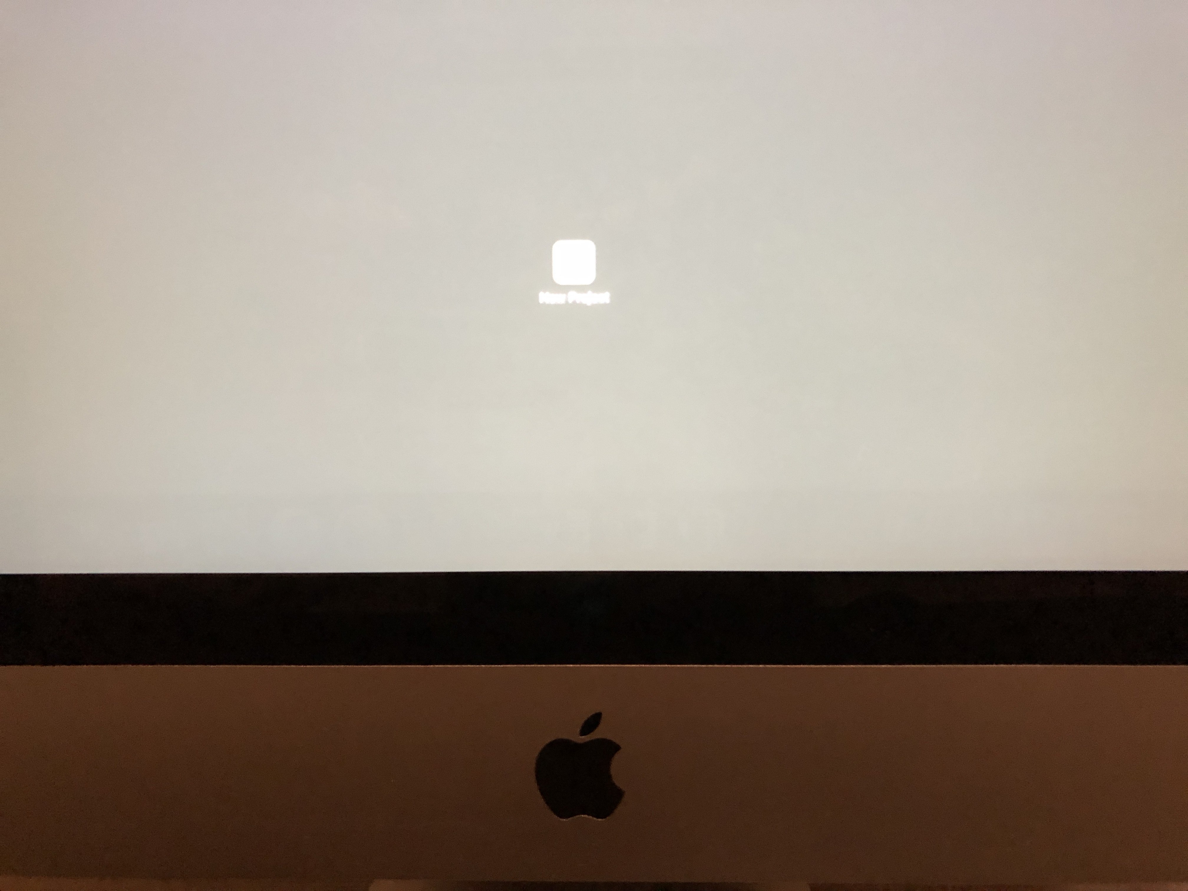

The IR shows up for less than 5 minutes as long as a screensaver (I use animated art) or full screen video is being played to move the pixels around. I can only notice this at max brightness and the ghosting gradually becomes more apparent over time with very minimal marks starting at 3 minutes after bootup, but only at the bottom where the dock lies as well as a subtle apple logo on the top left corner of the menu bar. Other than those areas it doesn't get much worse than the images I posted above under normal use.
I had like 4 different 2014 iMacs with the image retention issue. Go here:
https://marco.org/rmbp-irtest.html
and do the test for 5 minutes. Put the screen at full brightness and do not look at the screen as the test is going or your eyes wont be able to tell the difference at the end between retention or not. Remember to turn your screensaver to 5 minutes so it doesnt interrupt the test.
After the end (set a timer for 5 min) click on the "switch to gray" button and look to see if you can still see the checkered pattern anywhere. IF YOU CAN then please post an image here.

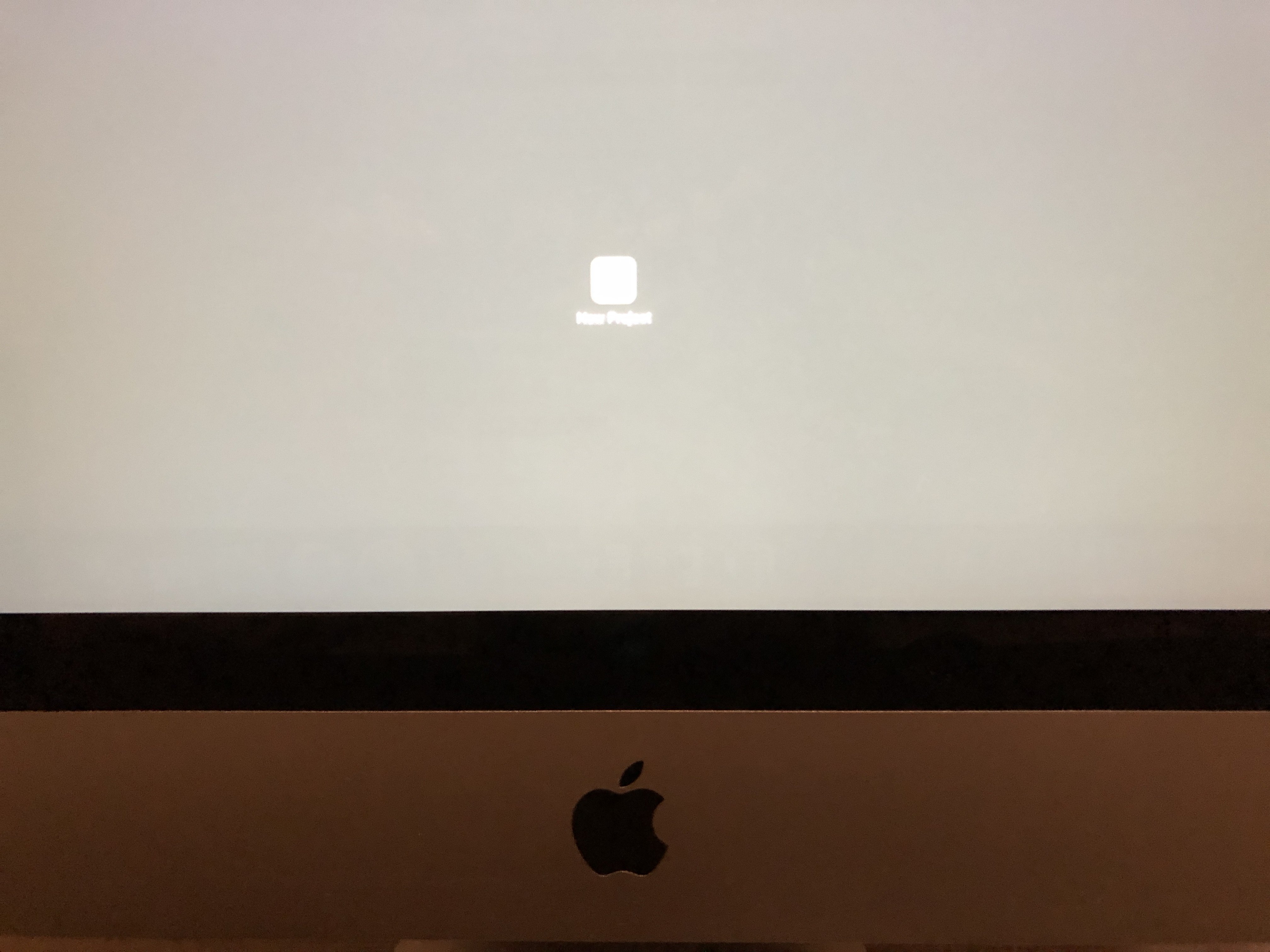

This looks like the classic image retention problem I've seen on nearly every iMac I've looked at since 2014.
In response to thefriendshipmachine's request, this is what my Late 2014 iMac 5K w/ Mojave looks like after 30 seconds of displaying the image on the screen. I had my screen at about 70% brightness.
That's 30 seconds of display! (The bright stripe is a reflection. Photographed with my phone, resized but not enhanced in Photoshop).
Echoing his comments, I'd love to see what 2017 iMacs or iMac Pros look like. I'm definitely getting AppleCare with my next computer — it is crazy to have to trade in a computer after 4 years because of an issue like this.

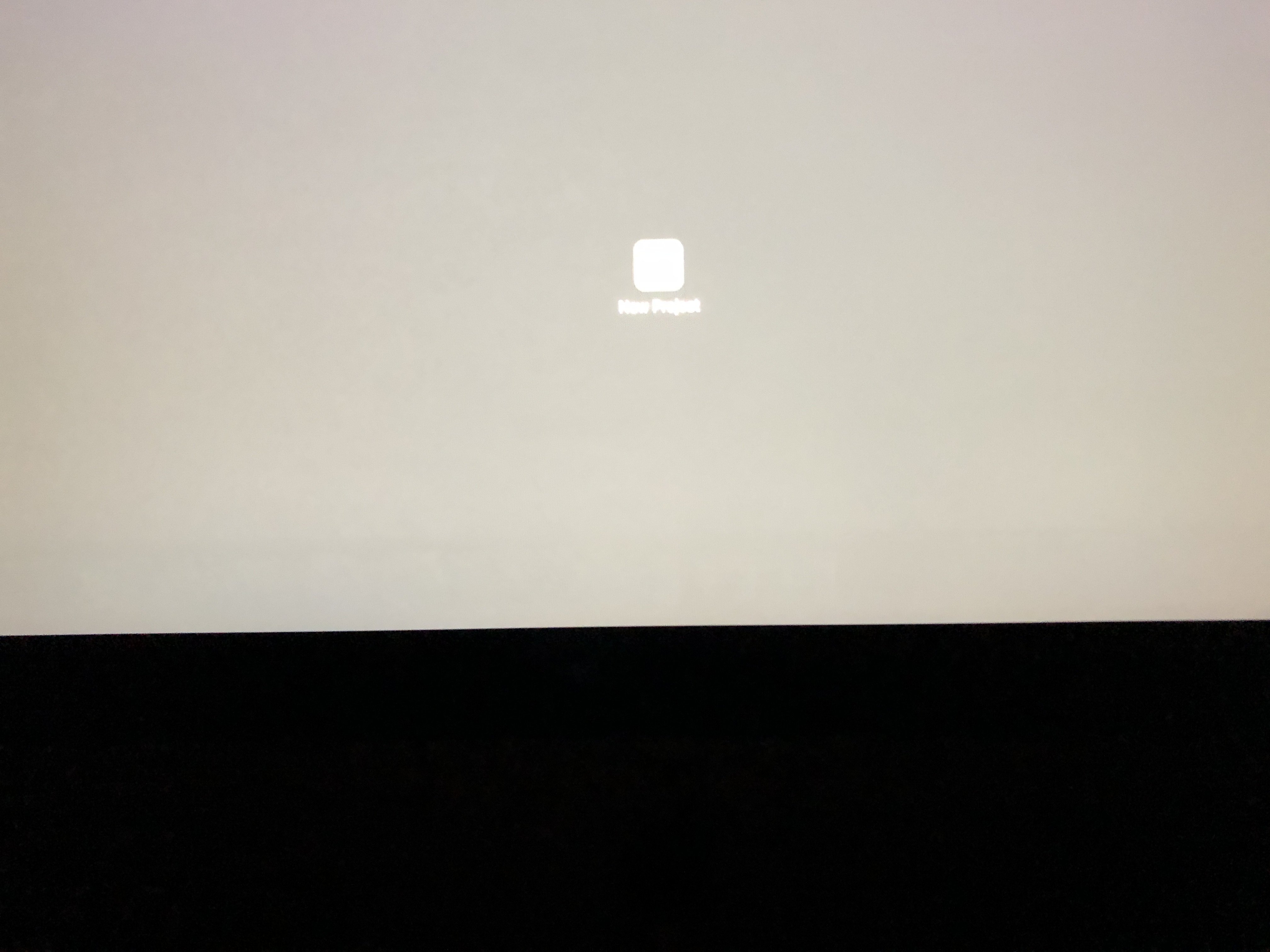

Only had the machine for 1 week.View attachment 746496 View attachment 746497
This is a known problem with all IPS panels, regardless of manufacturer. You can reduce the burn-in by creating a full-screen white image and letting it sit for a few hours.
