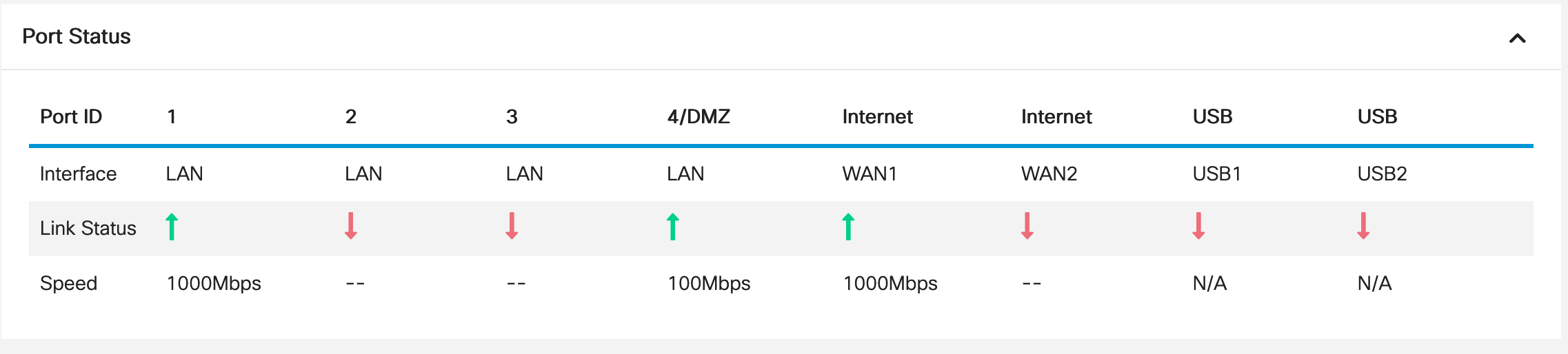

I am testing a Cisco RV340 small business router/firewall with my iMac Pro and have found that it does not do proper port negotiation. I am limited to 100 Mbps (here on port 4):
I know that the cat 7 cable and and port work just fine as:
1. I get the ~1000Mbps supported by my Xfinity modem when connected directly to a 10 Gbps switch
2. I have seen over 1 Gbps when doing file transfers over the network
3. Switching the devices on ports 1 & 4 also switches the negotiated speed rates
I have tried manually changing the port specifications in Network Preferences/Advanced/Hardware but it makes no difference.
Cisco is working the issue but I wanted to see if there is anything else I could do on the iMac end.
Just received a response from Cisco. The RV340 will not negotiate a 10 Gbps connection with an iMac Pro. Asked them to file a feature request.
