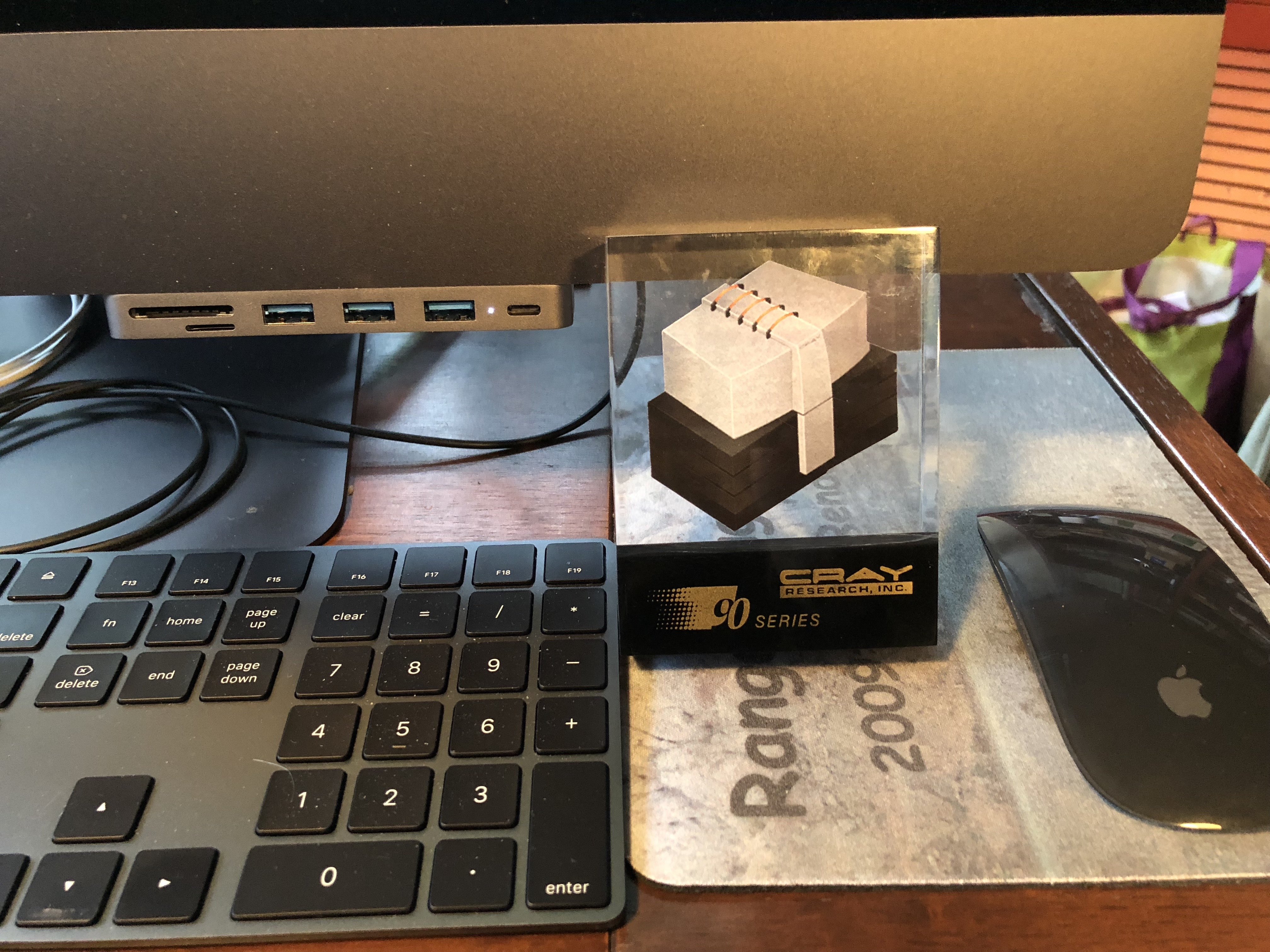

Couldn't resist this.... 😉🙄😀

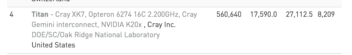

Yes that's true. Today Cray XK7 is #4 in the Top500 list.
560,640 cores at 2.2 GHz per core
Rmax 17,173.2 TFlop/s
Rpeak 27,112.5 TFlop/s
Power Use 8,209 kW

bxs what is the dock you have on the front of your iMac Pro.
I have tried a couple with my iMac but nothing will attach firmly to the tapered sides. I was lucky and retired on 29 June 1999 and took advantage buying Apple shares that day with a full year franchising. They were US $35 when the US dollar was less than the Aussie dollar and still have them.

It's not a Dock as such.... It's a SATECHI Space Gray USB-C Clamp Hub Pro.
