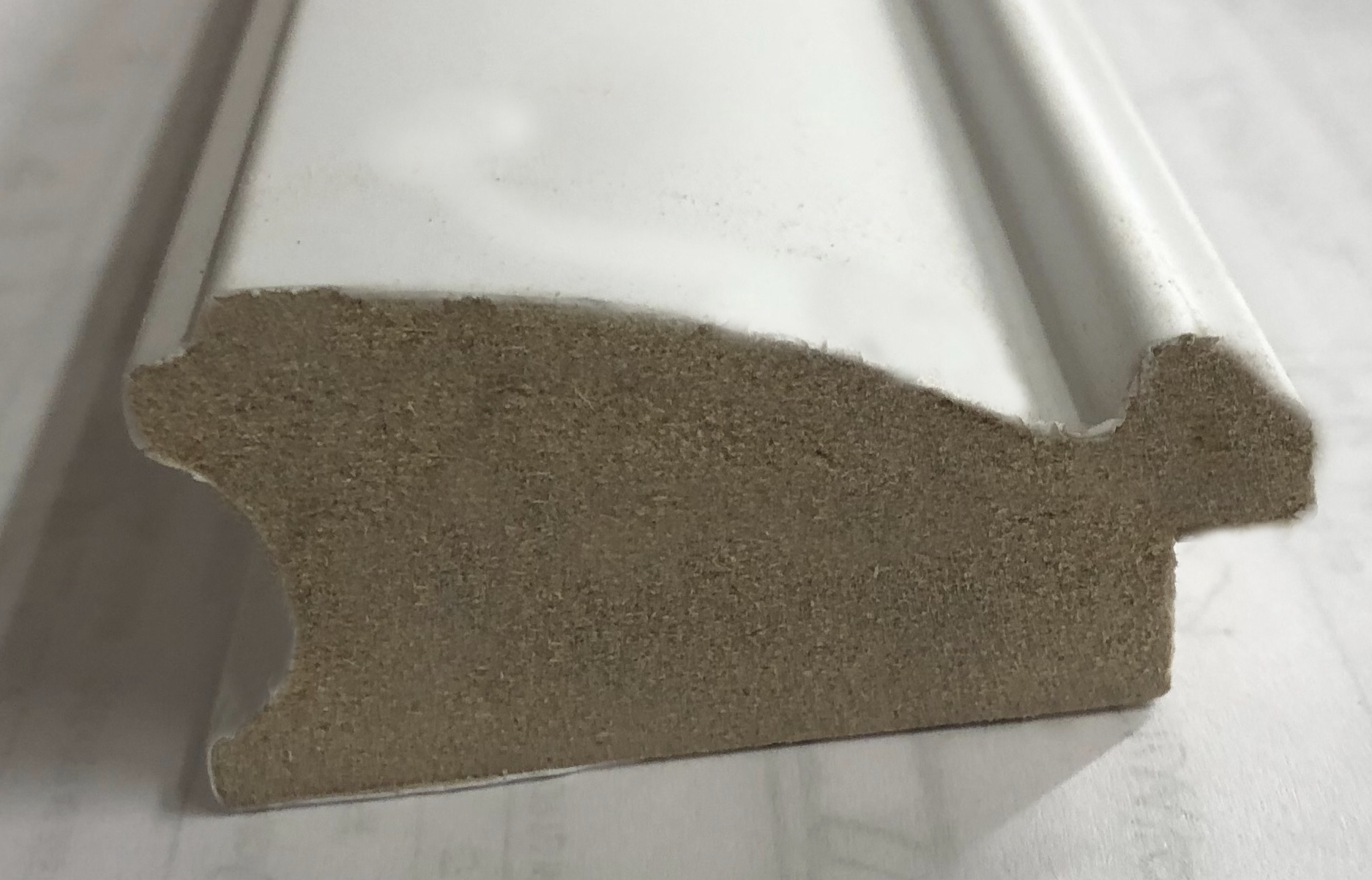

Thanks for your input, I am grateful to dialog; when I go into the HD info the file system reads:
File system : Mac OS Extended (Journaled)
Am I correct and is Apple, that reformatting first is needed and then downloading Mojave, and then uploading the Time Machine backup?

"Mac OS Extended (Journaled)" (HFS+) is the old Apple file format. The new file format is APFS. The Mojave installer will automatically convert your current HFS+ to APFS. You do not need to format to APFS before installing Mojave. I would recommend letting the Mojave installer handle converting to APFS.
The Time Machine (TM) backup will need to be done in High Sierra before installing Mojave. It is needed in case you have a problem and wish to restore from Mojave back to High Sierra. You will not need to restore your old data using TM during the Mojave installation. The Mojave installer will install over your existing High Sierra system leaving your existing settings, data and apps in place.
BTW: The attached picture in your post looks like construction moulding??

BTW, excellent picture of your iMac Pro screen 😉

Yes, not sure why that moulding section posted? Decorative mirrors and artist... thanks too for the what if advice re: staying put with High Sierra...Aint broke so...
