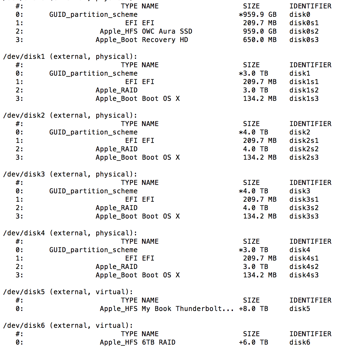

I tried to install High Sierra but I upgraded my internal SSD to an OWC Aura. When I try and do the install it says I don't have the proper partition. I was told that I need to reinstall the original drive, do the install and then put the OWC SSD back in and then it will let me install High Sierra on the Aura. Seems pretty convoluted to me?

I have spoken with OWC customer service, and they say I will need to reinstall the OEM SSD. Then upgrade to High Sierra, which will update the Mac's firmware. Then re-install the OWC drive, and upgrade that to High Sierra. I hope I can find the old drive...
Ok, so now I sort of understand, tho I'm not real sure how you installed on the drive in the first place?
I don't get the missing firmware partition, unless you don't have your EFI partition.
If you would post the results of Applications>Utilities>Terminal:
