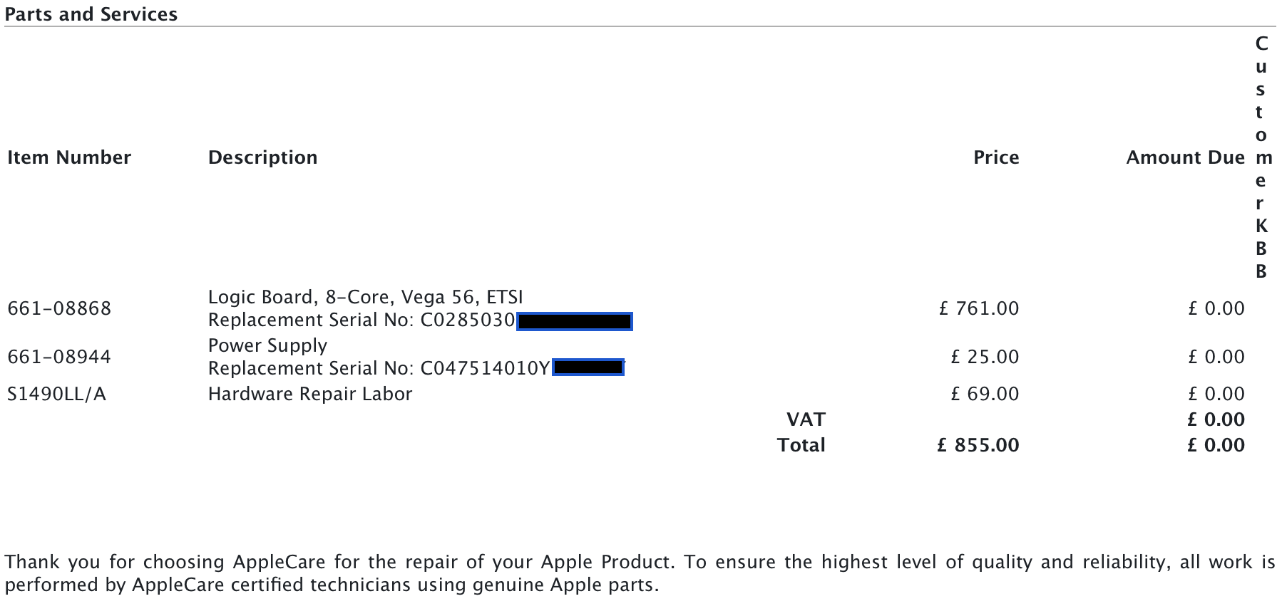

Not a cheap repair either:
Warranty covers it but yes, the price is rather high. One odd thing is the CPU - it is socketed but the logic board comes with one fitted and they get to keep the original even with a cash repair.
