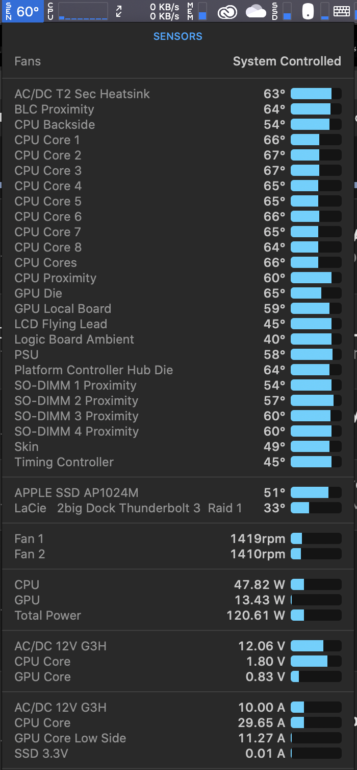

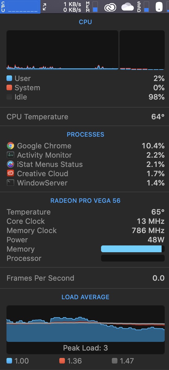

Imac Pro temperature is 60'C constantly. Is that ok?
What should I do if that's needs to be lower. Computer has now been working 2.5 hours. Just web browsing. See attached istat print screens. Thank you

That’s pretty cool afaik. You should be good. My 2013 iMac i7 is at 54 C right now with a Logic Board Ambient temp of 38 C. Outside temp is 18 C.
My 2009 iMac gets quite warm, but I run a 9'' fan at the rear of it. Keeps quite cool, now. I worked radio and TV servicing prior to retirement, and know from experience that heat is one of the main causes of component failure. I have just fired up a 2013 iMac which I bought recently, and it doesn't seem to go any higher than room temperature. I'm quite happy with that. No more draught from the fan.
At those same fan speeds my 27 inch 2019 iMac i9( 8 cores ) runs about 35C with only web browsing. If you have any concern about heat, you could always install a fan speed manager like Macs Fan Control. I don't think 60C is a concerning temperature for an iMac Pro but experimenting with a slight fan speed increase is worthwhile IMO.
It’s definitely on the hot side. Mine runs around 35-45. Could it have a lot of dust in it?

60 degrees Celsius is about 140 degrees Fahrenheit. That's pretty warm, borderline hot. Search the internet for "Macs Fan Control". Install it (its free). Adjust the fan speeds upward to cool it down. I keep mine around 105 degrees F or cooler.
Mine runs at 51 CPU and 62 GPU after running WoW (world of warcraft) for a few hours gaming.. (running WoW at native resolution 4k+ that is, no scaling)
Just to give you an upadate. 6 monts too late, but hope it will be helpful to someone in the future. I did have some conversations with Apple support. After multiple tests and diagnostics they did decide to organise the repair to have a look. It was under applcare warranty. So the result was: main logic board was replaced. No issues after that. And istats tempratures are mainly below 50 now. Computer is very cool. Not hot anymore.
