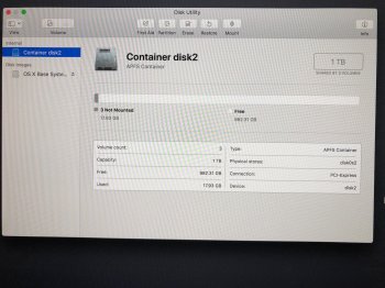

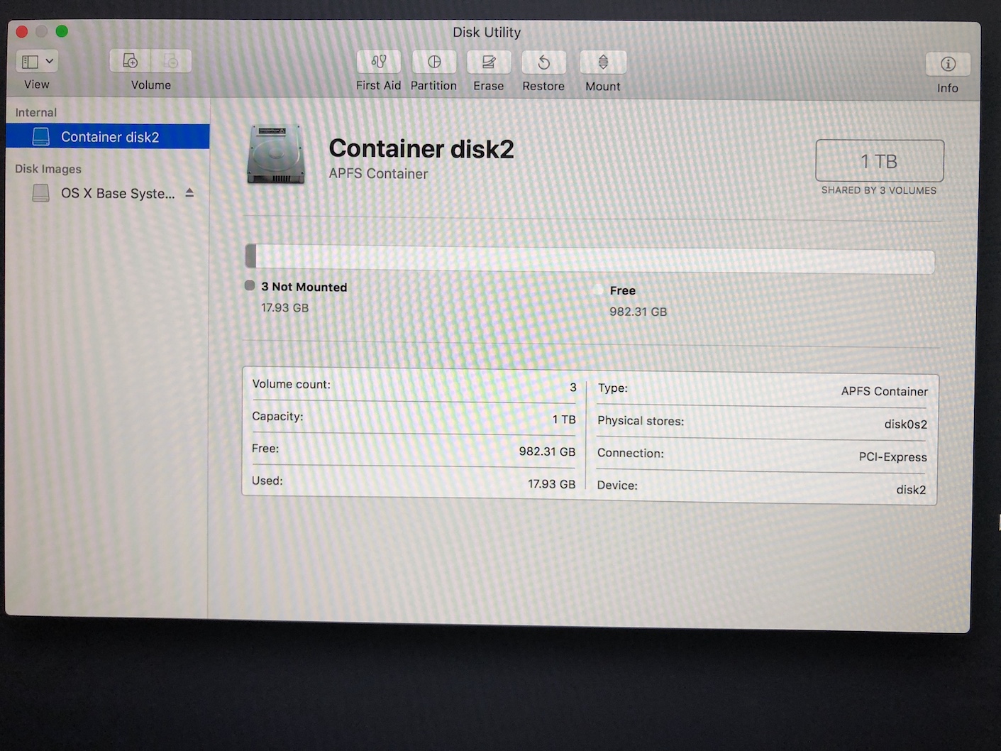

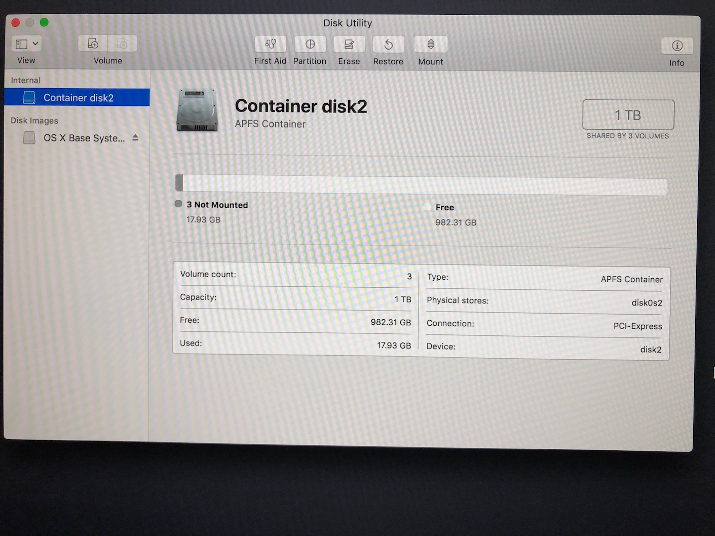

Uh oh, this doesn't seem so good. I erased my Macintosh HD, so I had to do an internet recovery and download the OS.
Now I have this screen, but should I be installing macOS on "Container disk2"? Seems a bit strange that I'd already have 18GB on there, unless that is just the base OS downloaded from the internet.

That 18 GB is a bit odd, but it is obviously your hard drive. Perhaps it's leftover from the wipe? Or RAID software to run the RAID0 configuration of the two SSDs in the iMP perhaps? Who knows.

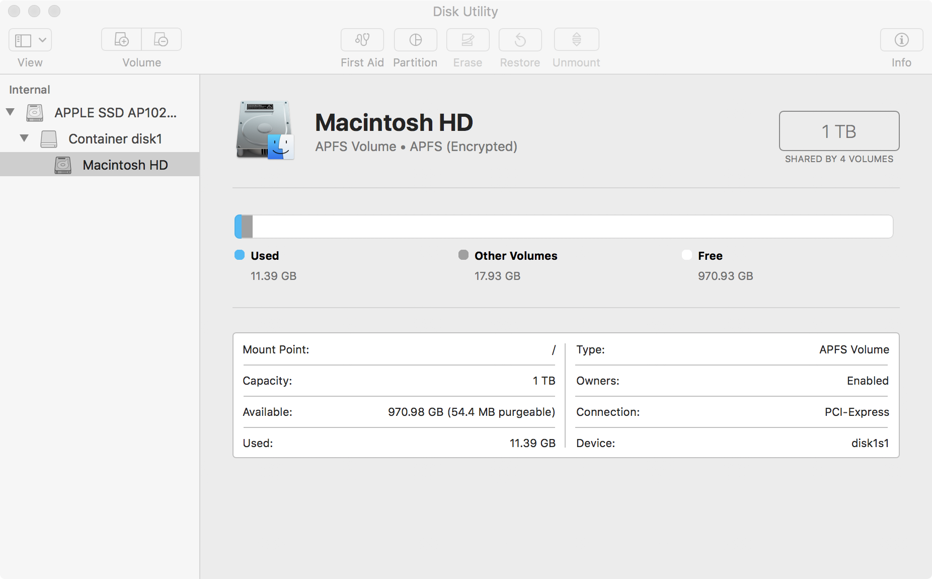

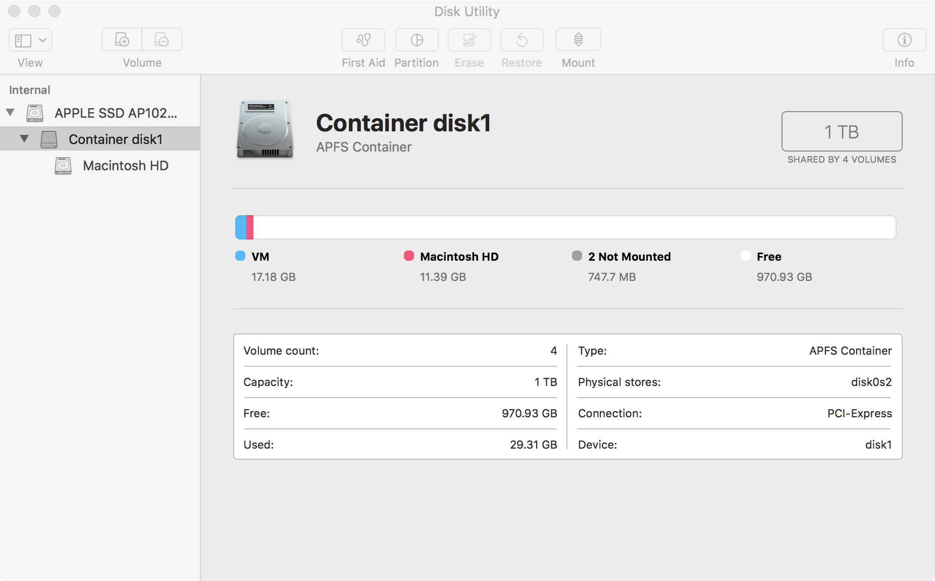

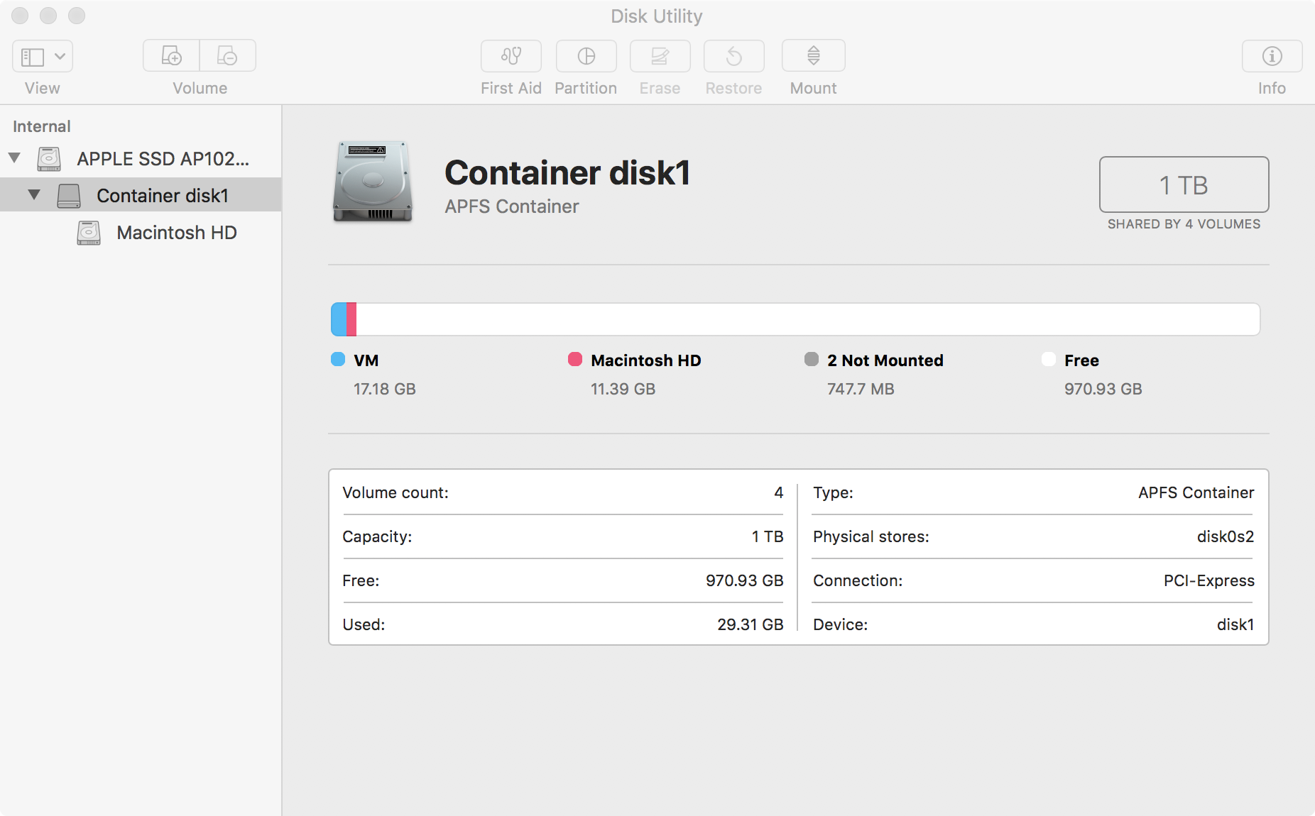

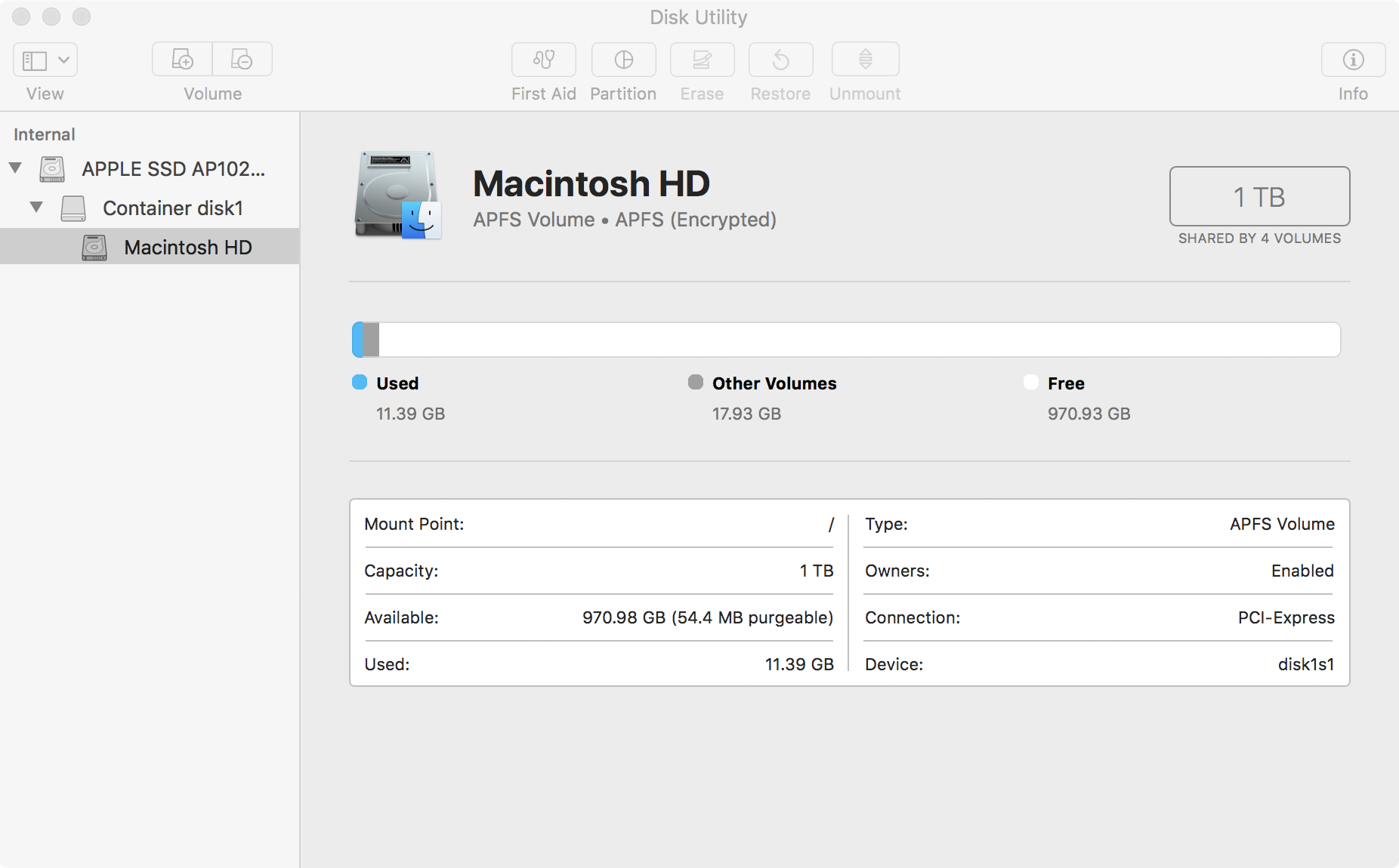

Yeah so this is strange and related to APFS. I looked at my other Macs with APFS, and they show similar "VM" or "Other Volumes" used in Disk Utility.
These two screen shots are from my iMac Pro, but my 2016 MacBook Pro shows 3.22GB of VM, my 2017 MacBook shows 1.07GB of VM. Note: you have to select View->Show All Devices within Disk Utility to see this detail.
What do you guys have?

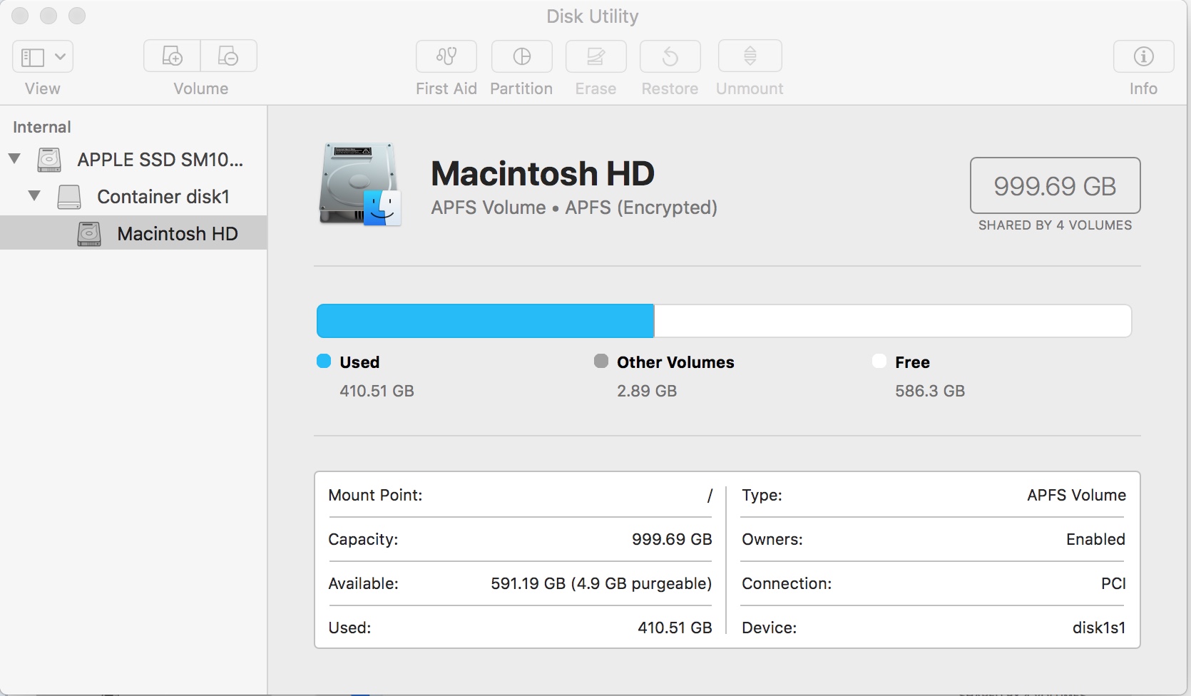

I have a small amount of something called "Other Volumes" but I assume it's APFS related tables or something. This is on my 2015 MBP - afraid I am still waiting for Apple to send my iMP, but I'll get back to you in a few weeks if it has the same problem.

OK, I found out from Apple what VM/Other Volumes is for. Basically it's reserved space for system RAM swap. So, nothing to be worried about!
