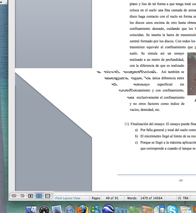

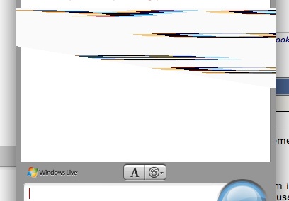

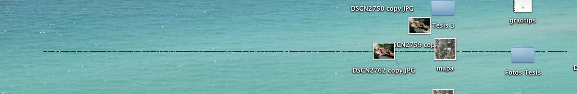

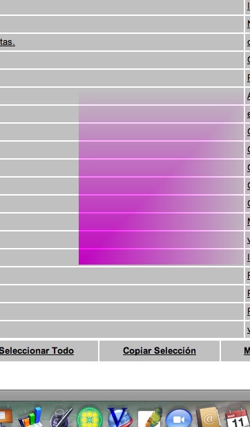

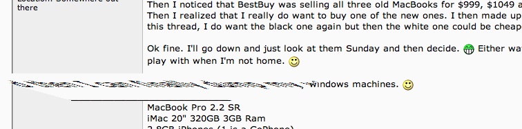

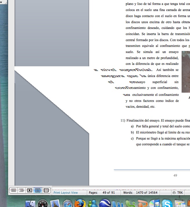

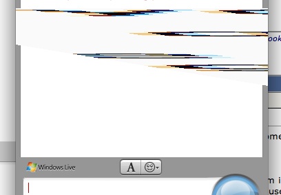

Ok... I'll try to explain all the problems i'm having with my iMac. First, my iMac is a Intel Core Duo 20" iMac with 1 GB of Memory. I bought this iMac in July 2006. This problem started in September 2007, so the computer wasn't under warranty anymore.
The problem started when lines started to appear in the screen, as you can see in one of the pictures (1.jpg) i'm attaching. Then all sort of weird graphics and colors started to appear as you can see in some of the other pictures attached. But that's not all, the computer freezes all the time, 5+ a day, so I did a clean Tiger install, and still the same problem, then I bought Leopard, doing a erase all and install and still the same problem. I live in Paraguay and took the computer to the authorized service and it seems they don't have a clue, they said it MIGHT be the screen, (over $800 fixing) but I don't see any relation between the computer freezing all the time and the screen. any clues?? I really need HELP with this computer! It is unusable!

Same here! I think it is the graphic card, I said that to them, and they told me that you can't change the graphic card in this model without changing the whole mother board, is this true?
Not sure how Apple does it. I thought the cards were on separate boards but I don't know if Apple will supply just the graphics card or force you/the repairman to order the entire motherboard+graphics card.
On your iMac, the graphics card is part of the logic board. The current generation iMac have a replaceable graphics card, but not on yours.
So basically if this is the problem, I have to replace the logic board, right? how much does a logic board usually cost?
dang! i don't know how much it will cost, except for that it will make the 169 for applecare seem like a genuine bargain.
Oh man, those pictures of yours really brought me back. I had the exact same machine: Intel Core Duo (Yonah) 20" and the EXACT same symptoms. The same lines, the same freezing that got worse and worse. 😕
It was probably a failed GPU but as someone else mentioned above the GPU is connected to the logic board and Apple only does one repair in this situation: logic board replacement. That was about $500.00 US for me here in Japan but I've heard it is more expensive in other parts of the world.

Thanks for the info SaSaSushi! Looks like it is the same problem. Fixing it here in Paraguay will cost over between $800 and $900, so I guess it's not worth it for a almost two years old computer... that's almost the price of a new one... I'll guess I will have to live with it and maybe try to convert my mac into a Lamp or something

If you're experiencing the same freezing as I did, jcandrada this will not be a solution for you. At first I just had some lines on the screen. It got worse and worse, looking like your pictures until finally it started locking up so bad I couldn't even complete booting up.
Strangely though, even at the worst condition I had no problems booting into my Windows XP Boot Camp partition. That had no freezing nor artifacts. It was only in OS X, at that time Tiger.
I really hope it turns out you don't have the same deal. There are a few third party places in the USA where you can get a logic board replacement for about $450 but since you're in Paraguay I guess that wouldn't help. 🙁
