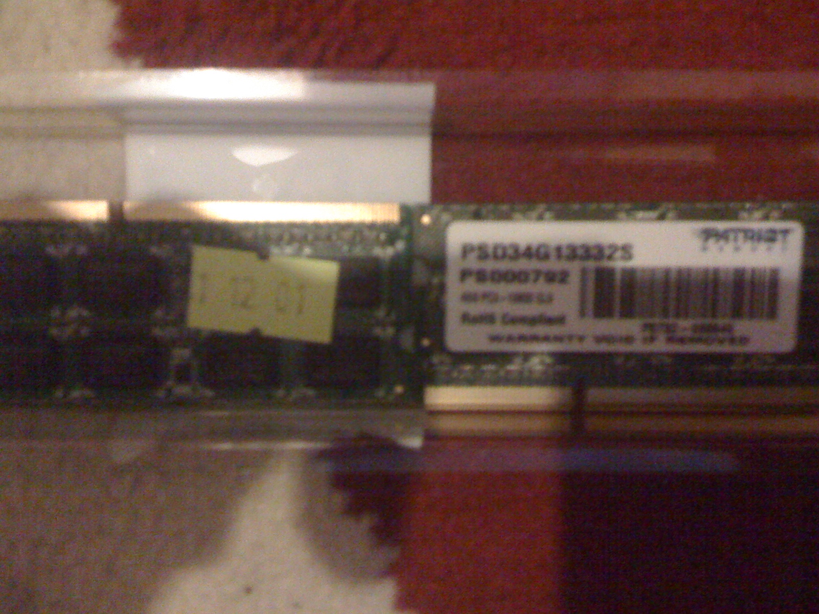

Thirdly ive attached a picture i just took of 2 of the chips but i have to apologize, the camera on my phone is abit crap. Not sure which details you need but the label on the front of the chips says "Patriot Memory - PSD34G13332S - PS000792 - 4gb PC3 - 10600 CL9 - RoHS Compliant - PS792-086545".

If you bought the RAM directly from Patriot, you may be able to return it. They actually DO have 'Apple specific' memory with different part numbers but (on the face of it) the same specs. The memory you have is a 'generic' version of Patriot RAM. Their product configurator does seem to lack more recent model iMacs, despite other pages listing memory for them.

EDIT2: Also, everything I'm seeing points to this model iMac using PC3-8500 (1066Mhz) RAM, whereas you have PC3-10600 (1333Mhz) RAM. If this is the problem, and I must admit to being a little rusty on backwards compatibility, it appears that you SHOULD INSTEAD have this:
http://www.patriotmemory.com/products/detailp.jsp?prodline=3&catid=34&prodgroupid=79&id=963&type=5

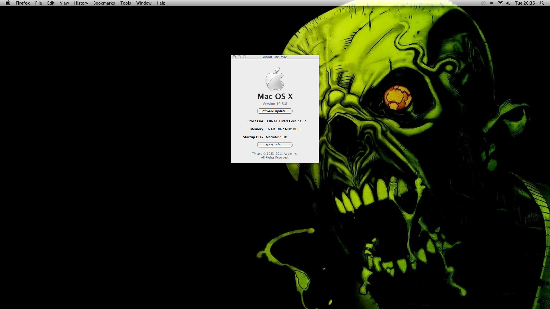

Quick update guys, i took the patriot RAM i bought back and bought some new RAM from crucial.com and well, the screenshot attached tells the rest of the story for me 🙂
Thanks alot for your help with this one guys, i appreciate all the comments and feedback received.
Must have been but im still puzzled as to why it would accept 8gb of patriot RAM and then crap itself when i tried 12gb (8gb patriot and the 4gb samsung that was in the iMac to begin with) or 16gb of patriot RAM.
Maybe the speed was too high? Only thing i can think of, but would that make the iMac think it had no RAM in it at all!?
