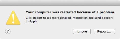

I had a similar issue that had the same error in the console:
8/31/15 10:59:40.000 PM kernel[0]: Previous Shutdown Cause: 0
but I also got a dialog after restart:
The details revealed that a program called CrashPlan Pro had a bad pointer which caused a kernel panic. Everything in the console since restart was an entry from the crashplan engine every 10 seconds. The crashplan menu item was grayed out, and trying to run the application failed. Reinstalling didn't fix it, so I had to uninstall it.
