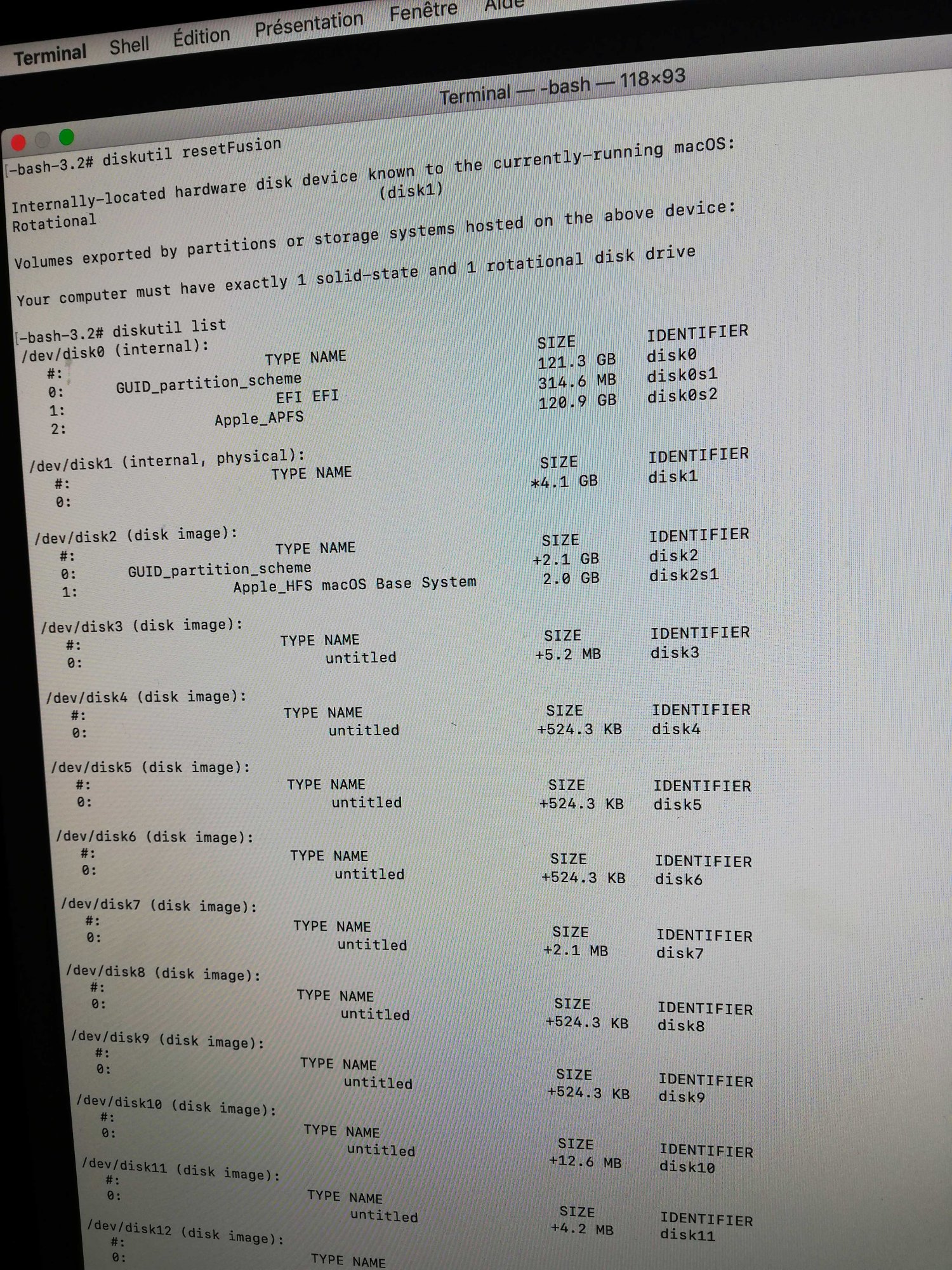

I need your advices. I have one imac with fusiondrive which does'nt boot anymore with the crossed circle sign and the url from support apple. If I boot on recovery with cmd+R and try to reinstall macos I have no disk proposed to make the installation.
With disk utility I can see the SSD part of the fusion drive and another one on wich I can't do anything, which is labelled as 4Gb as it is a 2TB rotational disk...I can't make any repair on it, even erase it...
With diskutil I have :
Guess disk1 would have been the 2TB rotational disk (even if on other imac with same conf it is disk0).
It's dead isn't it ? If you have anything more to try, I'm listening...

"With disk utility I can see the SSD part of the fusion drive and another one on wich I can't do anything, which is labelled as 4Gb as it is a 2TB rotational disk...I can't make any repair on it, even erase it..."
That sounds like the HDD portion of the fusion drive may have failed on you.
It looks like you still have the 128gb SSD portion operational.
I hope you have some kind of backup, otherwise the data that was on the drives may be lost for good.
