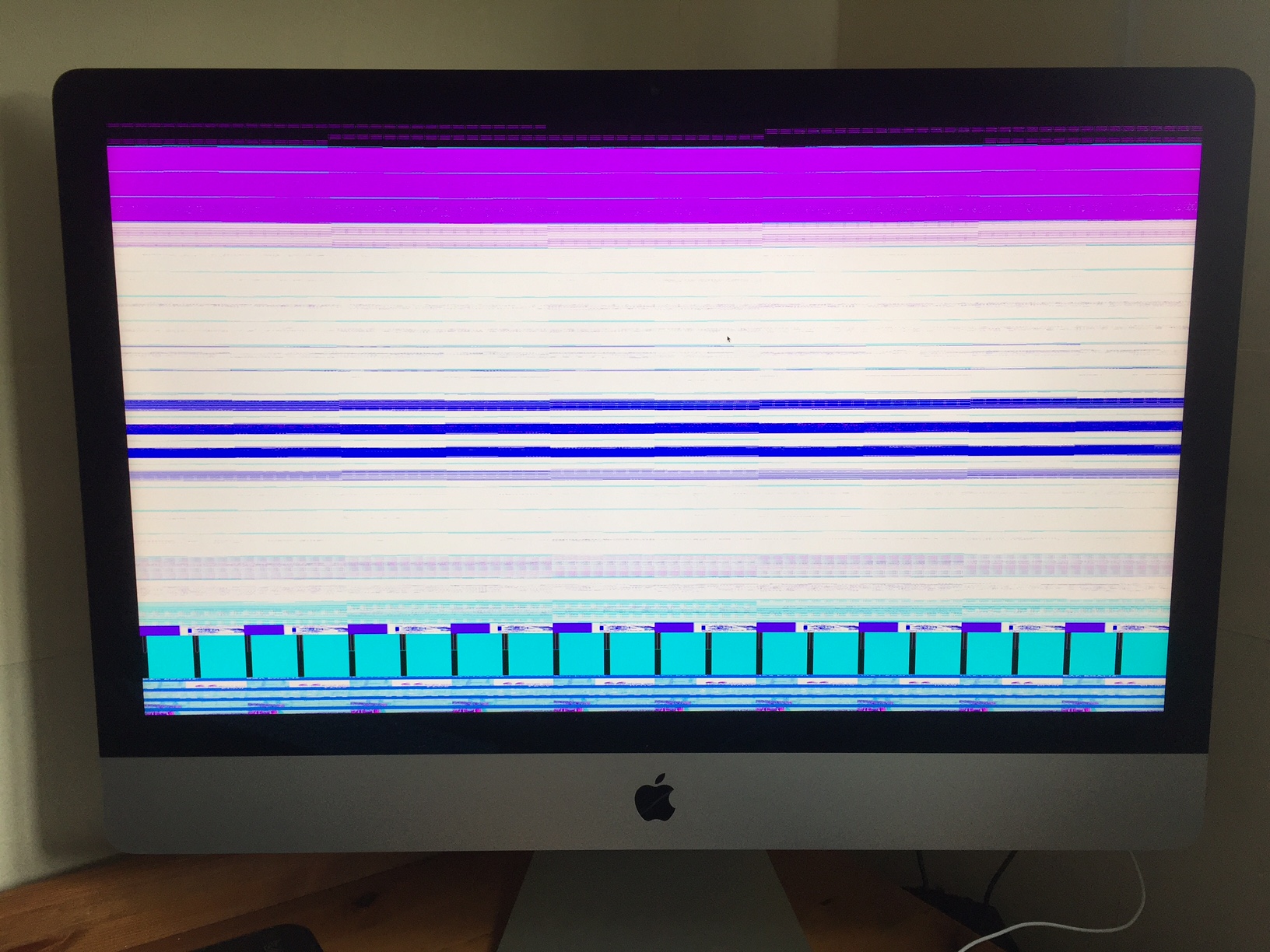

When I shut down iMac (27" 2016 early version) a screen with distorted colours appears and shuts down. This does not happen every time I shut down the system. I think it appears when I do not shut down iMac for several days, instead I normally put it into sleep mode.
I tried to take a photo of the screen but I could not as it flashed about 1 sec and turns off.
I wonder whether this is normal when not shutting down iMac for a significant period of time or not.
Anyone is having the same issue?
Managed to take a photo of the screen today.
This started for me late '15 27, with the Sierra release and forward..again on occasion and only on shutdown. Nuisance but doesn't seem to hurt anything. Maybe a wonky kext or something...
I took my iMac to Apple genius and it went to repair. They told me it could be the logic board which is causing this issue as gpu was not the cause.

I have collect iMac today and turned on and off for about 30 times to see if the issue is gone or not. For now it is seemed that the issue has been resolved.
The guy at the Genius told me that the logic board was replaced. I asked him whether it was refurbished one or not. He said it was a new one but I believe it could be a refurbished one 😛
At least a distortion is not occurring so I am happy for now. I will update if it occurs in the future. Apple care paid off.
