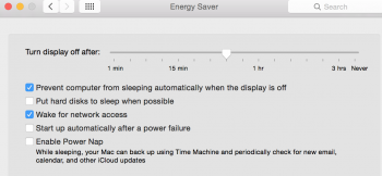

That's not an option in this model (see attached). So I have the display turned off after an hour and the tick box to 'prevent sleep when display turns off'. But I don't understand why a transfer would stop if the display turns off. Unless it's still going to sleep? As soon as the touch the mouse of keyboard, it's right at the lock screen so I don't think it's sleeping....?

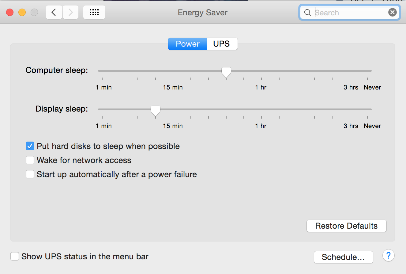

On my 10.10.5 screen I see these controls:
10.10.4 - 5K imac, I have this
