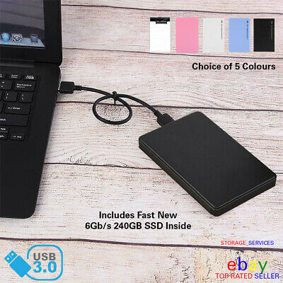

Looks like the drive. I would stick to a known brand. I bought bought a couple of these from Amazon uk
and tried one with an old Samsung 840 evo. Got speeds of 338Mbs write and 388Mbs read.
