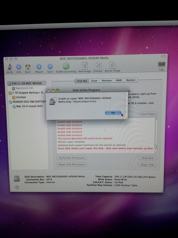

    [​IMG]
    This is the prompt when trying to back up into Seagate 2tb
    [​IMG]
    This one is when trying to repair disk..

    you can try starting the computer in Safe mode buy restarting the computer and immediately holding the shift key for the duration of the start up. But, in general it sounds like your hard drive died. What year is it? I know it will not help to back up your files if it is dead but there was a few years spanning like 2009-2011 that Apple was having a HD replacement program b/c the Seagate HDs were failing.
    There is a way to transfer files from one computer to the next via an ether port or a fire wire (maybe USB or Lightning idk) But i'm not sure it'd work if it is that the HD is dead.

    If you hit "OK" in that last screenshot, does your HDD mount? If it does, you won't be able to clone or use Disk Utility for copying. However, you may be able to simply drag the data, folders, etc. from that drive to your new external drive.
    That internal drive has died. I had that happen on an old Mac Pro 1,1 only two weeks ago, and I saw the same dialog box pop up. After many attempts I was able to get the drive to mount, and copied most of the files and folders off it. There was one file that would not copy, and I assumed it was simply badly corrupted. In this case, the files were routinely backed up monthly, but hadn't been for a month, so she would have lost a months worth of work.
    I tested that drive after removing it and it was completely spent. Every block, except the first few tested as bad.
    As the previous poster mentioned, Apple has recalled certain iMacs with Seagate HDDs. You can enter your iMac's S/N here to see if yours is one with the recalled drive.

    When it's mounted, it is seen as a hard drive icon on your screen desktop. If it shows there, click on it twice to open it, and drag the data from there to you external drive icon. You can select all, or if that doesn't work you can drag individual files and folders.
    DiskWarrior works well when the disk directory becomes corrupt. It may or may not help in your situation. Yours are the symptoms of a failed hard drive. Although, DiskWarrior is a good utility to have on hand, I use Tech Tools Pro, which did help me to at least mount that failed drive in the Mac Pro I mentioned in an earlier post. But, it did not repair the drive. Western Digital's Diagnostic utility (for Windows) later showed that drive as completely failed.

    The disk is spent. You'll be lucky if you're able to get anything off it at this point. It's likely you can't write anything to that disk with those types of errors. If it mounts copy what you can. Then, try what you want... DiskWarrior, as mentioned, if it was able to repair those directory problems, may prolong the usage, but that drive likely has some serious problems that will recur.
