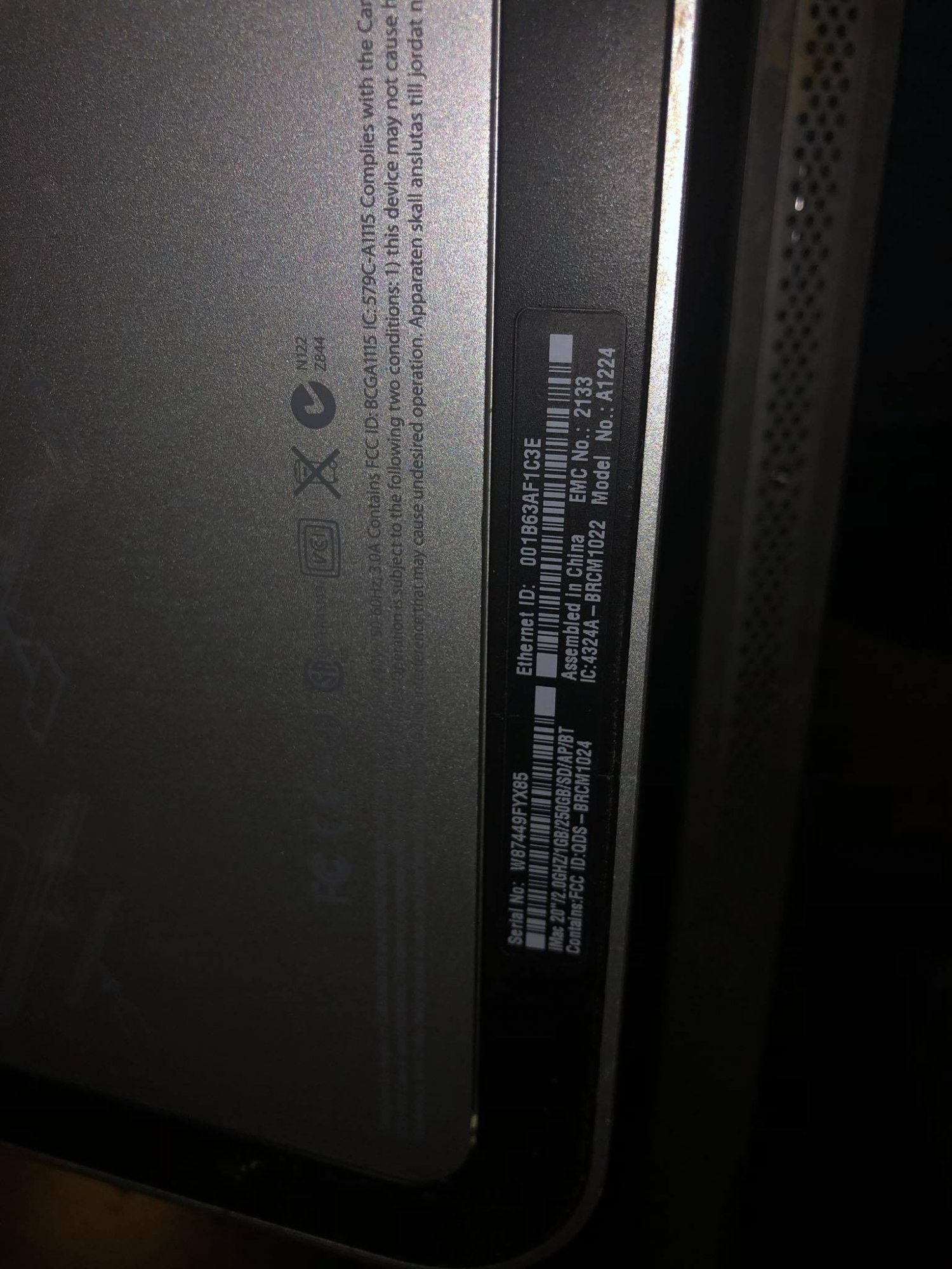

Hello apple community,
I have this iMac model number A1224 that wont go past the login screen. I type my password correctly because I tried typing an incorrect password and it says incorrect. Once I hit login it goes to a blue screen for a few seconds and then gets back to the login screen and it asks again for the password. I have tried starting the iMac on safe mode but the same thing also happens on safe mode. Below I have attached a video of the iMac's issue and a picture of the iMac's information. I dont really care if it doesn't work I am mostly worried about the hard drive as there is a lot of old pictures in this iMac and I hope to recover it... If anyone can help me I would very appreciate it!!! Thank you all for your time and have a nice day.
