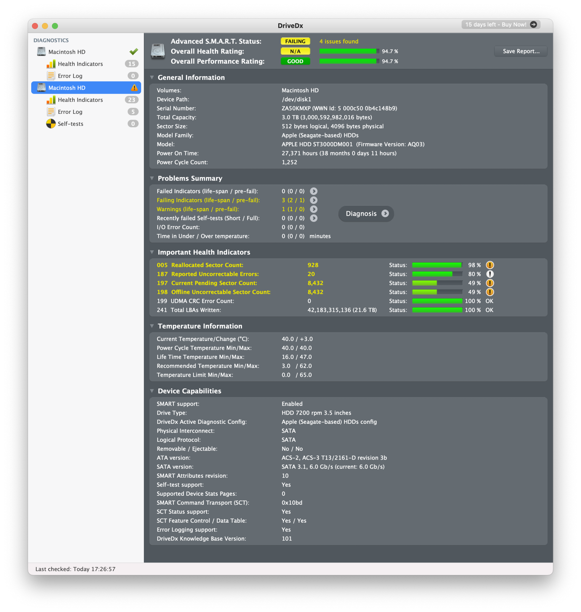

Everything has been unplugged from the computer except the keyboard. I have backups, but not bootable backups.
It only took about three hours to get it to run, but here's the output of DriveDX. Doesn't look good.

DriveDX says the SSD is fine.

I'll probably replace the internal hard drive with an SSD so external will be a moot point.
Yeah, fusion drives are notoriously flaky, some work without issue for as long as you want, some start to get sick and then die, and some die without warning. I'd second the external SSD, it will be much faster than simply adding a SATA SSD internally, unless you were already planning on doing the blade drive. It also saves you the trouble of taking the machine apart. If you really want to open up the machine, then replacing the AHCI SSD is the best way to go.
