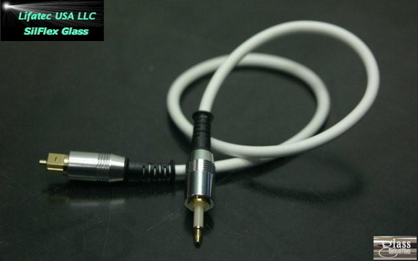

Yep it is, just remember to make the most out of it, DO NOT use regular 3.5mm headphone jack.
Buy mini TOSLINK to TOSLINK cable like this:
And also set your audio output in System Preferences/Control Panel to Digital out instead of regular headphone jack.
