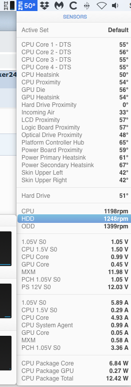

I have an Imac Mid 2011 with 16GB Memory.
I am finding the top of the monitor really hot (i usually leave the mac on as i don't have a SDD and takes a bit loading up sometimes). At the moment i have a small desk fan at the back facing up to cool it down.
I am not doing anything heavy i am just browsing the web using firefox or chrome and downloading videos etc. The only heavy thing is Football manager 2019 which i close everything down when i use it.
The temp of the Computer at the moment (only have mail and chrome open) is 54 CPU and 51 HD (had the fan on for about 25 mins). (attached is a screenshot from istat) . The temp before the fan was 58 to 59 when the top of the monitor was very hot.
Not sure what the temp should be normally but it was the heat at the top of the monitor when i was moving it a little that i thought was not right.
Im using Mac Sierra High (10.13.6)
Cheers
Keith
The top of your iMac is where the exhausted warm air leaves the machine and normally is hot. Just make sure that the bottom air intakes are not blocked or covered with fuzz or dust. The iStat temps that you show and the three fans speeds are in the normal range. I'm using my iMac in an air conditioned room where the ambient temperature is set at 78 degrees F. And even at that, the top of my iMac and back exhaust opening is warm.
Thanks for the replies. Sorry should have mentioned in the original post. The temp is in Centigrade.
Thats good to know about the top and bottom. the bottom is not blocked at the moment and will keep checking it.
The temps you're seeing are completely normal. It's all about the utilization of your CPU and the frequencies it's hitting.

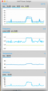

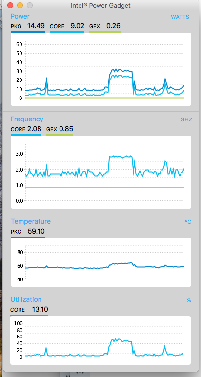

Thanks for that. just reassurance i guess. I am playing FM 2019 for the past few hours (more like 4-5) and the system is at 60. Just downloaded Intel Power Gadget.
This is What Power Gadget comes up with. If that sounds good then as mentioned reassurance.

I have a 2011 iMac too with High Sierra and those temps seem OK to me. Probably idles in the 40's though.
If I'm gaming, they go up to around the 70's (possibly higher) but I try to mitigate it by using 'smcFanControl' which have set up with a variety of fan speeds - I just manually kick them up or down depending on what's happening. Lowering the resolution and using vsync to keep frames per second down/stable on certain games helps too, depending on how demanding they are (I'm not sure about Footy Manager 2019).

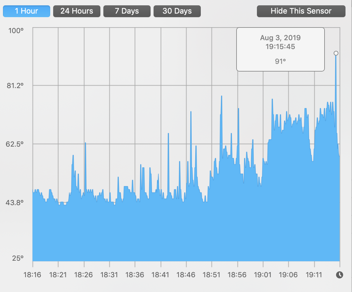

Completely normal.. Mine just passed 90 while playing Batman Arkham Asylum which is like a 10 year old game.
Will have a look at smcFanControl. Someone mentioned it but was not sure how to use it. . The only thing with FM is when playing the match as is a bit more on the graphics.
[doublepost=1564874534][/doublepost]Wow, Thanks for that. never had it that high before.
No worries. These iMacs are designed to run hot, so don't sweat it. 🙂

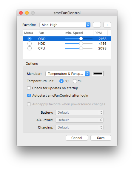

Here's a screen shot of smcFanControls preferences. You just set up some Favourites with the plus button and the sliders then you can use the pull down menu from the main menu bar to select different favourites for the active setting.
I ended up creating ones for low, medium, medium-low, medium-high, high and full and have settled on a medium-high when I'm gaming. It's a little noisy but I stop noticing after a while and rather keep the internal temps down a bit having had the graphics card pack in after 4 years.
Thanks Bertrude.
I have downloaded and use the same settings for the moment. I have never changed any setting since i got my mac so this is a first.
Will have a look and make other favourites.
