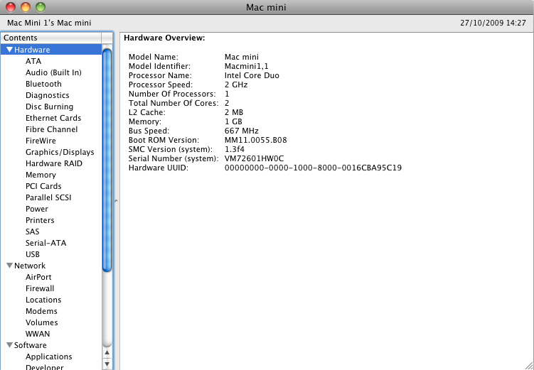

Well thats the mini done, up and running fine. temps sitting between 36-50 C depending on load.

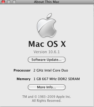

iMac (coreDuo up and running now)
The iMac is obviously quite a bit slower now, but I'm just going to stick it in my kitchen for recipes until it dies and grab itunes off of it.

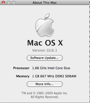

as for the mini, I can now watch BBC iPlayer HD content with no stutter. Seems to be a LOT faster now with the 2.0 CD in it, but part of it probably comes from the fact that I doubled the RAM as well. But SL ran great on the mini when it was a stock 1.66GHz. A definite improvement over 10.5

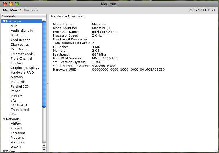

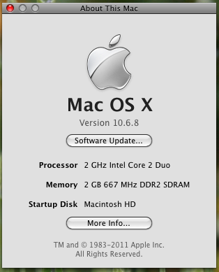

well, its done. i found it a bit easier than last time, mainly because i'd done it before. The C2D chip seems to run a bit hotter than the CD, around 55-60 C at idle, topping out at about 90 C running BOINC manager. CPU Heat sync is usually 2-4 C different from the proc.
