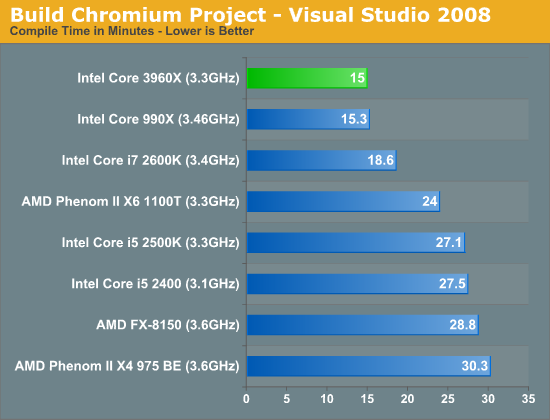

This will give you an idea of how a CPU will affect a build time, although you have to consider that Chromium is one hell of a build 🙂
Here is an overview of the 2011 iMac processors
http://www.anandtech.com/show/4340/27inch-apple-imac-review-2011/2
The base 27" iMac has the base i5 2500S 2.7 GHz CPU
The $1999 27" iMac has the i5 2400 3.1 GHz CPU
The top end 27" iMac has the i7 2600 3.4 GHz CPU - which can compared to the 2600K in the chart since it's just a locked version (cannot be overclocked) of the 2600K and a couple other minor differences
http://ark.intel.com/compare/52214,52213,
You can look up benchmarks yourself but often the 2500S in the base 27" is faster than the i5 2400, but the base has a slower graphics card...
