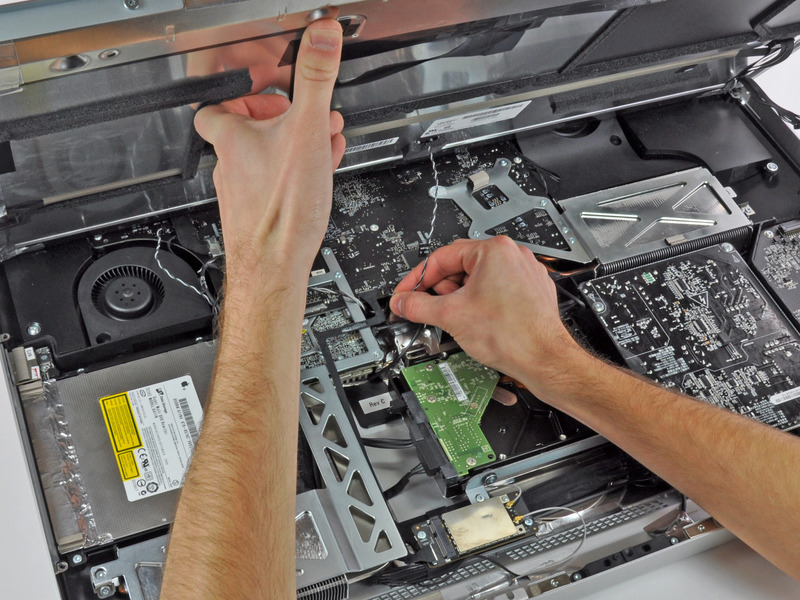

HDD replacement guide from iFixIt. It is not that easy and can take up to an hour, as the iMac was not made for customer modification.

Thanks. But my question was not only on how to disassemble the iMac, but if there is a vacant slot for the SSD (if I want him to use both the SSD as well as the old one, however booting from the SSD) or if I had to replace ie. a DVD drive.
Taking a look at that guide, then there is no visible space for an extra SSD like the current iMac offers.

You have to actually replace the HDD with an SSD.
I did so with my 2007 iMac and use an external Firewire 800 enclosure with two 1.5 TB HDD to house the big files, as the SSD is only 60 GB in size.

You can either replace the hard disk with an SSD or maybe a faster hard disk.
