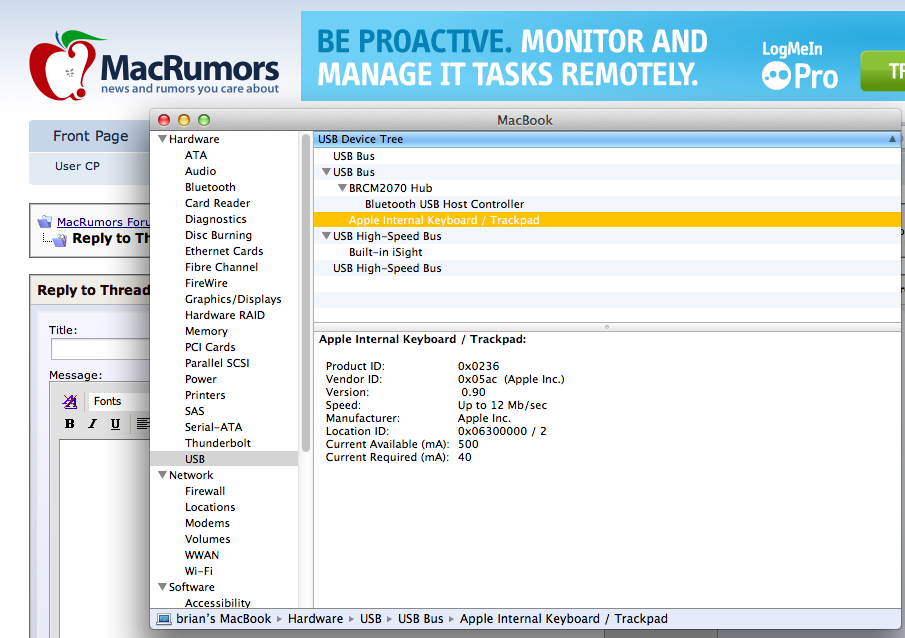

You understand this is what we have system information for. See what it says at the bottom? You'll know if it is hardware or software immediately.
