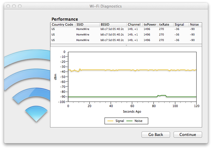

That is an ugly chart. I ran the performance monitor on my system and the signal was a nearly constant -37 and the noise a nearly constant -90. Your signal fluctuations make me wonder if you've got interference.

Can you show me what yours looks like?
Here is my chart.

Oh **** lol
Any ideas about hOw to fix interference
I'm wondering now if your chart is illustrative of a bad wifi card. If we assume your router is putting out a good wifi signal (because your iPhone and iPad connectivity is good), then maybe what this chart shows is a wifi card that is not receiving a constant signal. That could explain the dropped connections.
