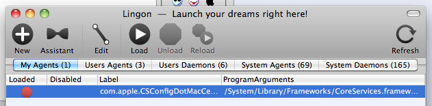

The UI looks like this.
You were right. I downloaded Lingon and deleted it and everything went back to normal. Thank you so much you guys.
