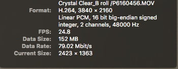

Okay, I just did that, what do I have here?
[doublepost=1528502250][/doublepost]Here's the screen shot from the inspector

And I'm guessing this h.264 isn't RAW, so is this the similar to photography where the h.264 is like a jpeg and not easily edited for color and exposure when compared to a RAW file?
Indeed, it's not RAW.
The data rate is about 79Mbits / 11MBytes per second which isn't much. If you measure your disk speed with Blackmagic as I told you earlier you should be well above that, unless you have a hardware problem.
Your bottleneck seems to be the CPU and/or GPU.

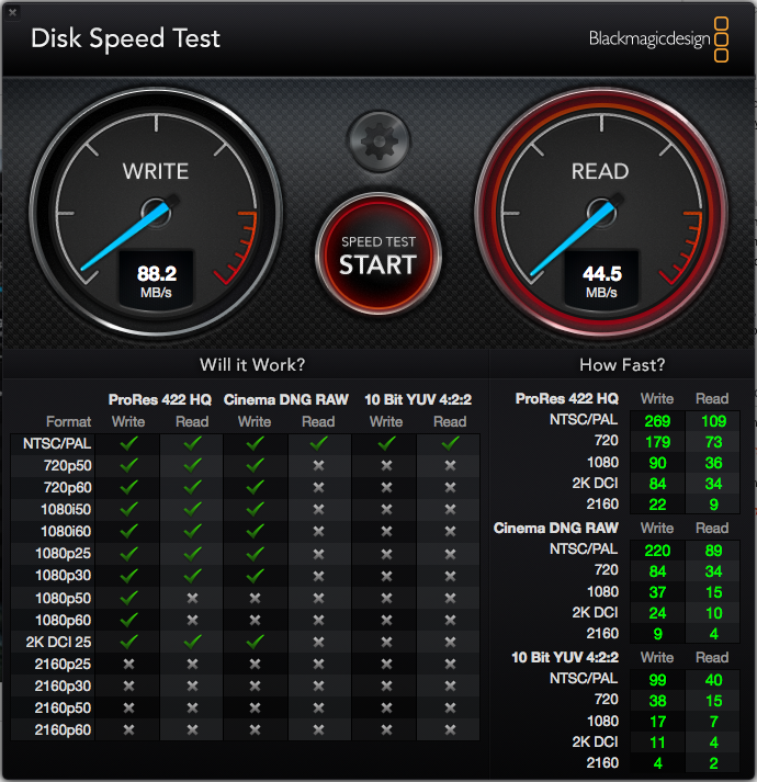

[doublepost=1528695609][/doublepost]I just did the blackmagic test on my drobo 5D:

(3) Even Thunderbolt 1 should be much faster than your Black Magic speed of 88 MB/sec write, 44 MB/sec read. There may be something wrong with the Drobo, or it's configured wrong.

Sadly, Drobo won't help me because my drobo is now out of warranty and they want me to buy a new one....I think the drives are fine, there's 5 of them in there and they are not too old. It's got to be something with the drobo or my iMac

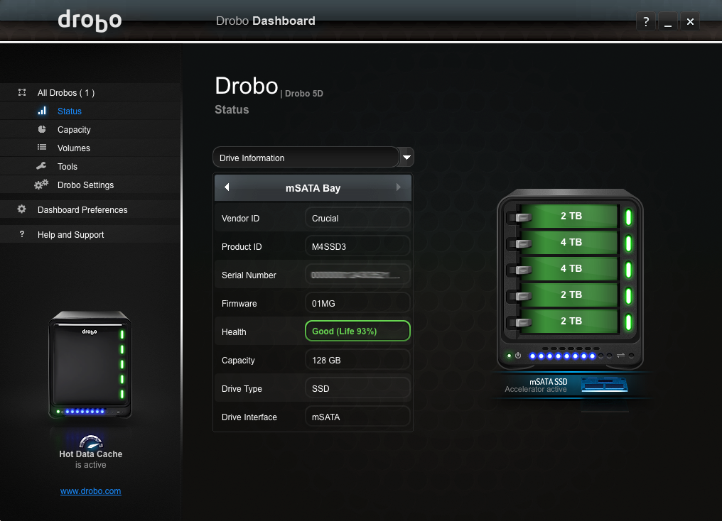

Did you check your Drobo to see if it has a mSATA card. It was behind a door on the bottom of our Drobo. Ours went bad twice. We finally gave up and removed it. Our DN works fine without it. But if the mSATA card is bad it will slow you down. There is also a list of compatible mSATA cards on DROBO web page. Only some work.

My mSATA card is showing good on the drobo dashboard....do you think it could be bad while still showing good below? I did not hook it up to another mac yet but I will find one soon. Until then, it's frustrating that drobo can't support this especially considering the drobo exports a diagnostic file that they can read on their end:

back up your information first then you have to test it on a second mac with different cables. The speeds you are showing are very low. Buying a new computer may not solve the issue. You need to eliminate problem sources first. Even a new drobo may not fix the issue if it mac related. Could be a bad thunderbolt port in your mac. The easy way is to test it on another Mac. After seeing you drobo report I am betting you have a Mac hardware issue. Test it.
