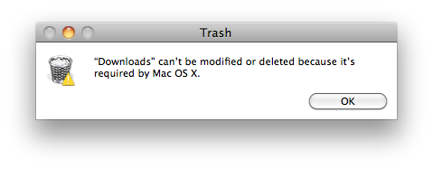

Indeed there is a problem... OS X will not let me move the folders containing the user data. Deleting them gives the same message, see picture.
I was thinking of removing the folders using sudo in the terminal, but I am not that big a hero that I will actually do that. But so far I am stuck with a drive or OS that will not do what I want it to do. Maybe Lion will solve the problem or one of you guys has a genius plan?

Supersid, I think all you need to do is login as a different user, move the downloads folder you want to move to the HDD, right click on it (the new one on the HDD), select "more..."from the list and select "create a symbolic link". Take the newly created symlink and copy it to where the original downloads folder started out (ssd). Of course you will have to delete the symlink on the HDD then. Then delete the original downloads folder (ssd) leaving only the symbolic link in its place, and it leads straight to the newly relocated downloads folder (HDD). Then log back in as yourself. That should do it.
Alternatively, once again logged in under a different account(or maybe not necessary just to copy it), you could copy over your whole home folder to the new location. Then go to the system prefs/Accounts pane and right click on your account to get "advanced options" button. Click on that and you will see "Home Directory" about half way down. Click the "choose" button and select your new home folder and thats it. Home folder relocated.
This all sounds complicated but its very simple I just don't know how to write it simply.
If you don't want to be a command-line hero you can still do my original suggestion (which puts every user file, including those in Library, in the HDD), or you can do links or aliases (slightly different but works fine for things like iMovie that have hard-coded folders), and as pointed out some programs (iTunes, iPhoto,...) allow relocating their libraries.
Supersid, I think all you need to do is login as a different user, create a symbolic link of the downloads folder(of your main account) you are hoping to move, then move the actual folder to where you want it.
He wouldn't have the appropriate permissions as another user, so would have to use the su command from the command line to change user. At this point he would be a Command Line Hero.
ah indeed, maybe I was overthinking it. It should, however, allow him to copy and paste the folder(s) he intends to move while logged in to his main account, correct? then do the symlink stuff i talked about, or in the case of the entire home folder just go to accounts and redirect to the new copy.
* should work I can copy and paste any system folders I want to just tried it. I've always had my home folder on another partition it's not a difficult thing to do anymore without using the terminal.
