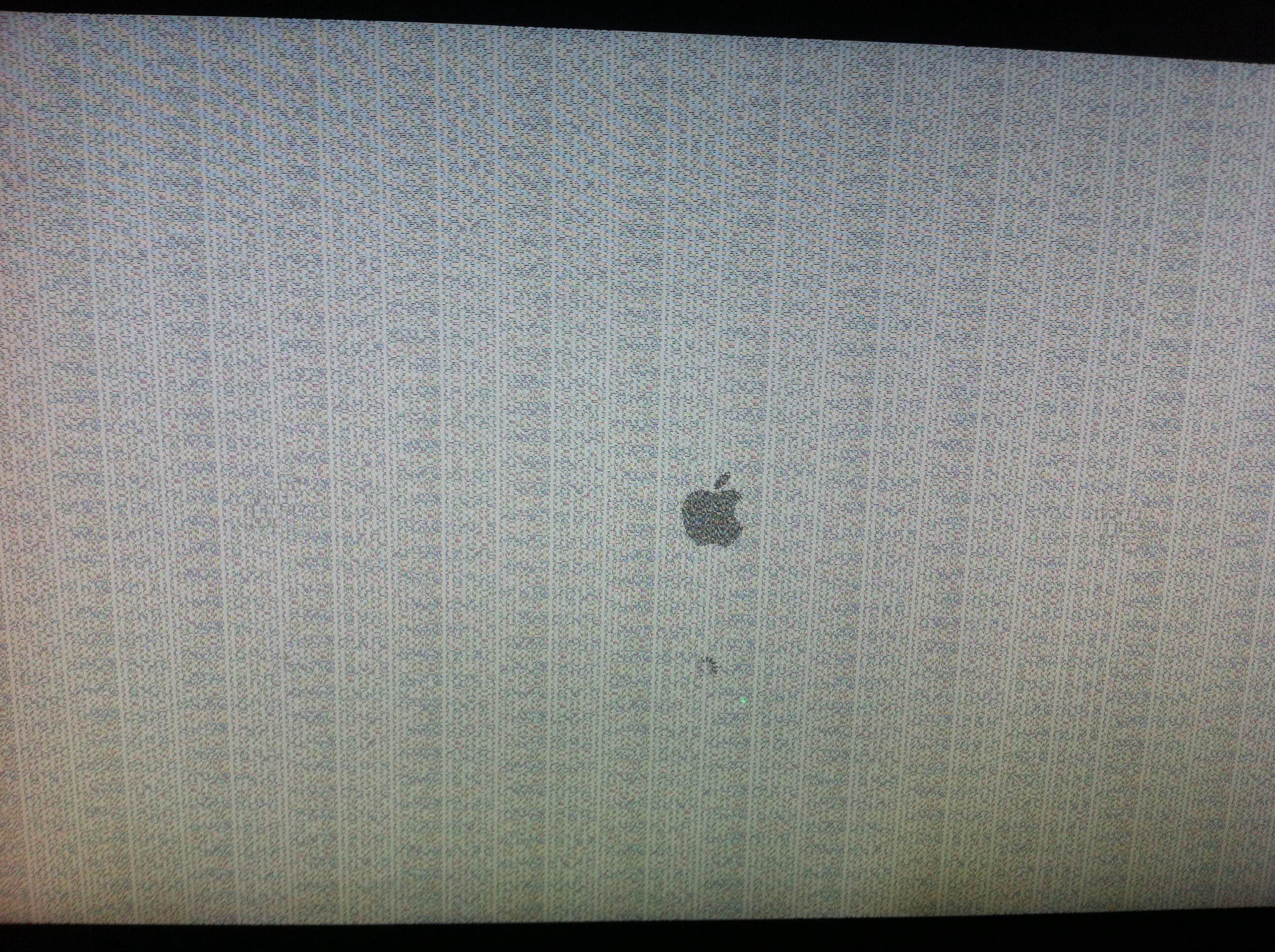

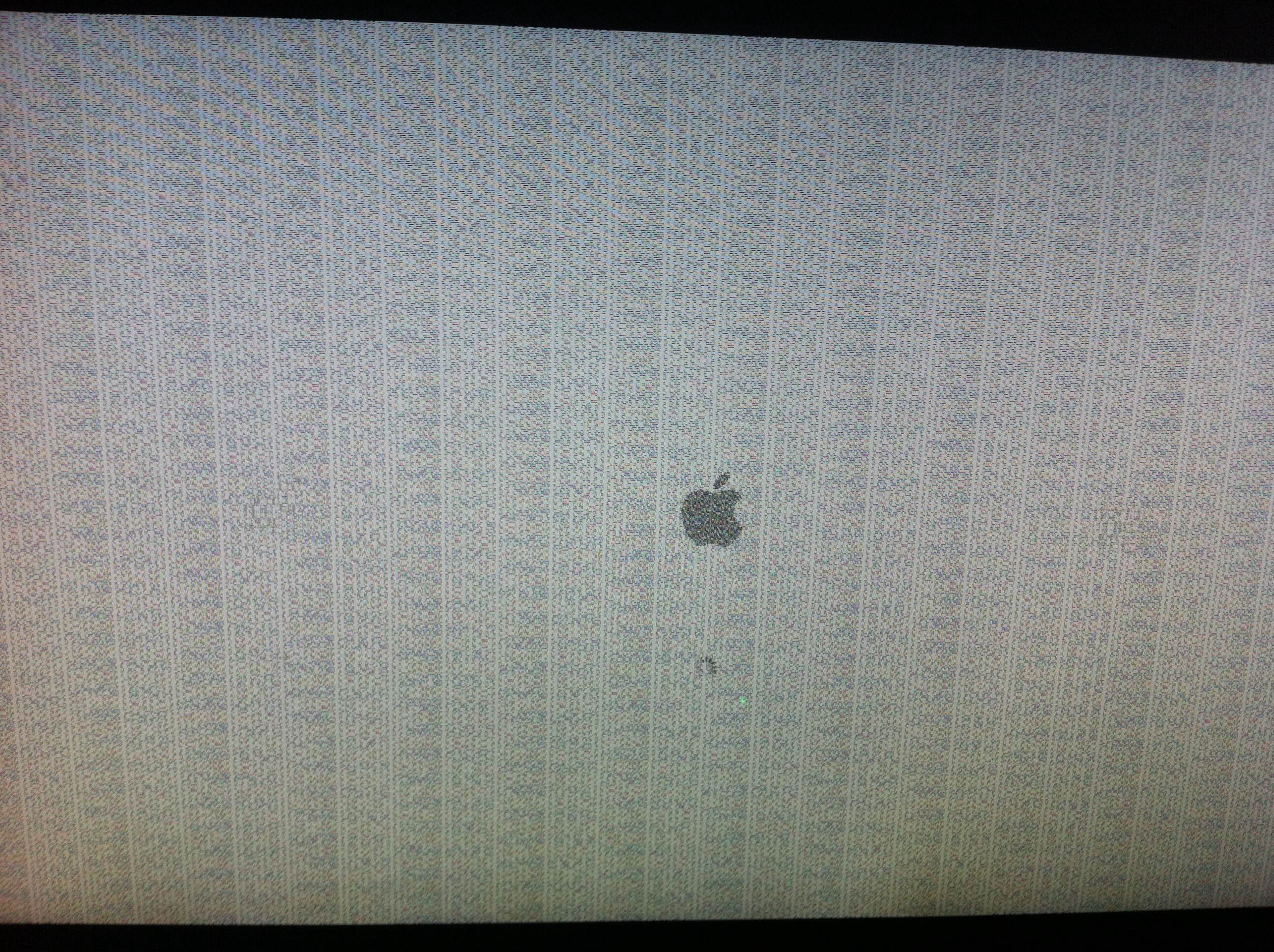

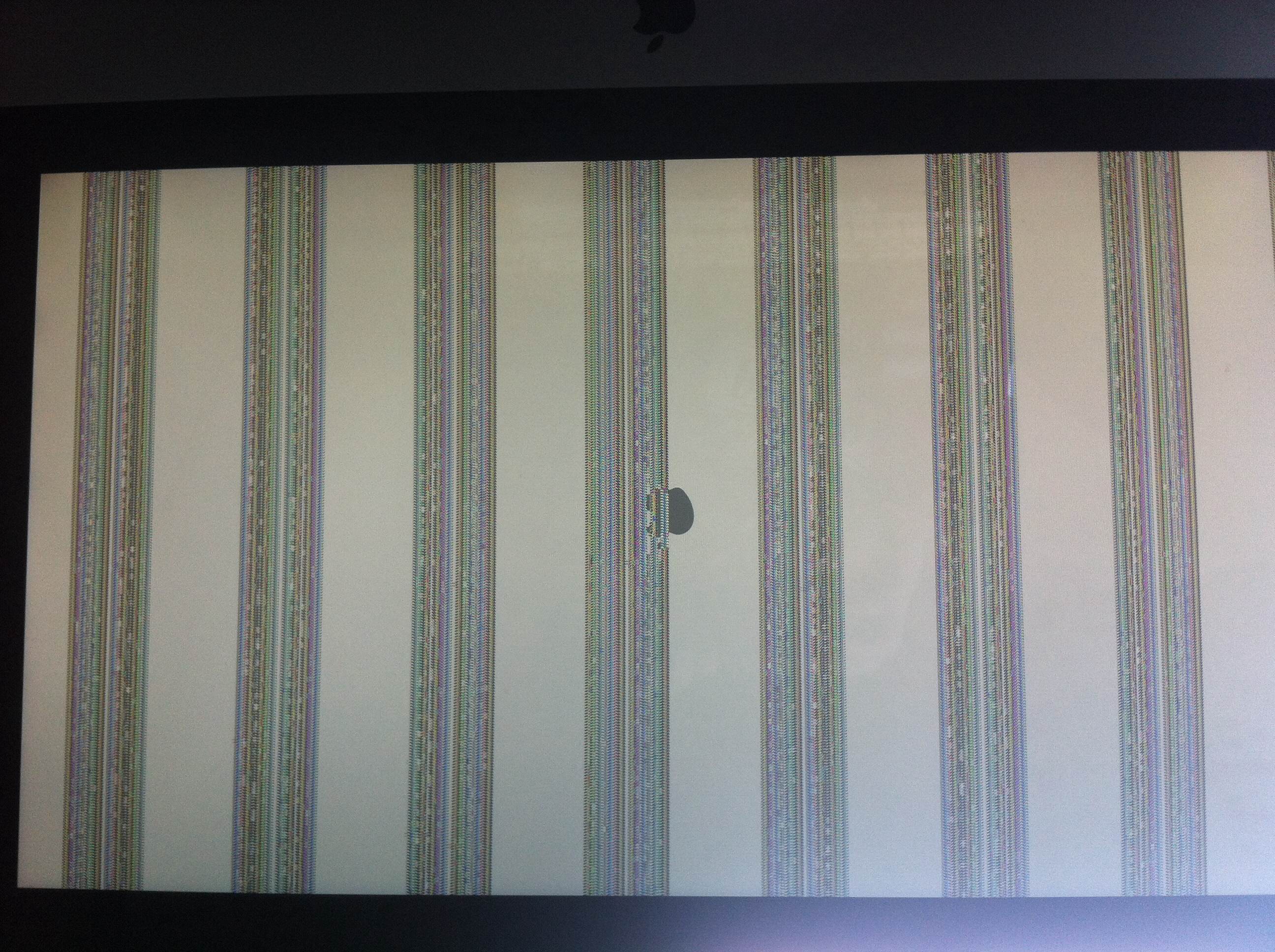

Hi, so my imac from around 2009 crashed yesterday, while playing a free indie game. The game was not graphically intense, and the imac was running at no more than 50 degrees celsius. All of a sudden the screen became really blocky, like it stopped inbetween two frames, on half of the screen showing one frame, the other half showing a different frame. This in a checkerboard patern.
At first i tought it was just the game crashing, since it was a indie game. But when i used te power button to turn of and on the iMac, a random pattern appeared on the screen, and after about two minutes it whitescreened. I left it at the whitescreen for over 2 hours, but it didnt change.
[/URL][/IMG]
Then i started to worry. I looked up the problem, and found some threads.

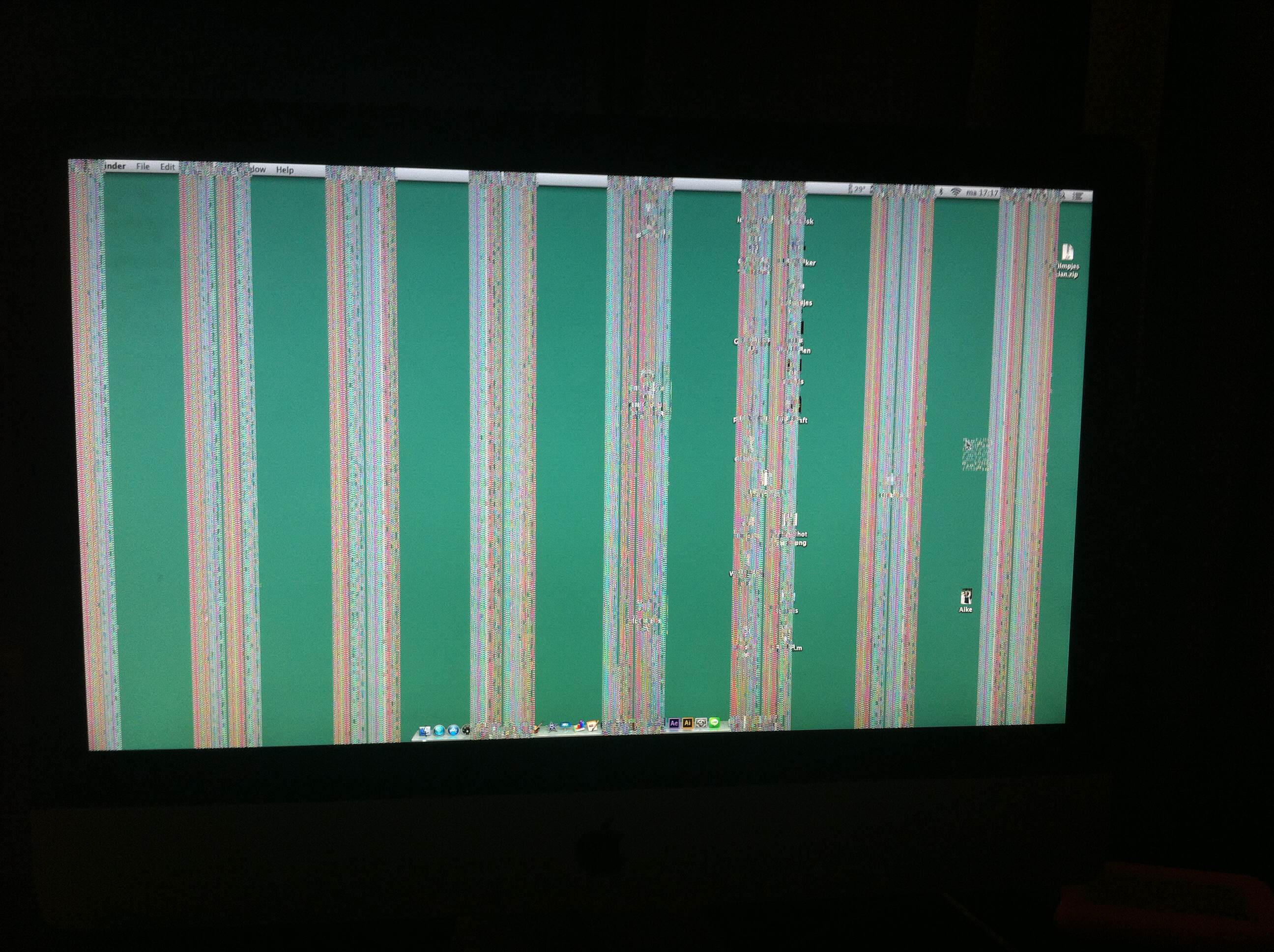

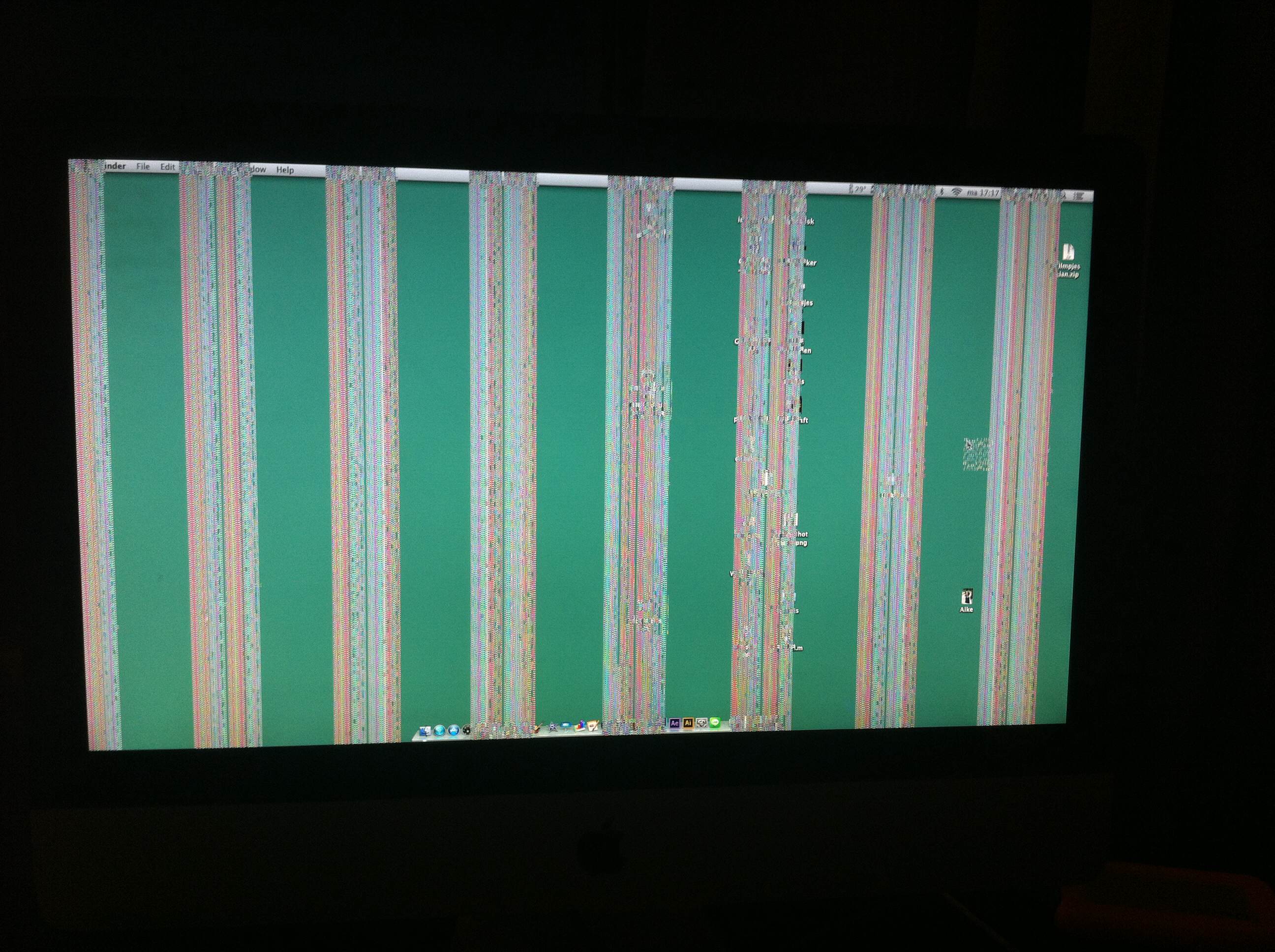

After trying some methods. Since i dont have the apple hardware test disk anymore i couldnt run that, i did reset the nvram and pram, and boot it in safe mode. In safe mode it did boot, but there were these giant lines on the screen
[/URL][/IMG]
Also i can't acces the internet in safe mode, altough i don't know if this is normal.
I did just back-up all my stuff on the iMac, and will probarbly visit the genius bar sometime this week, but if anybody know this issue and how to fix it, please tell me.

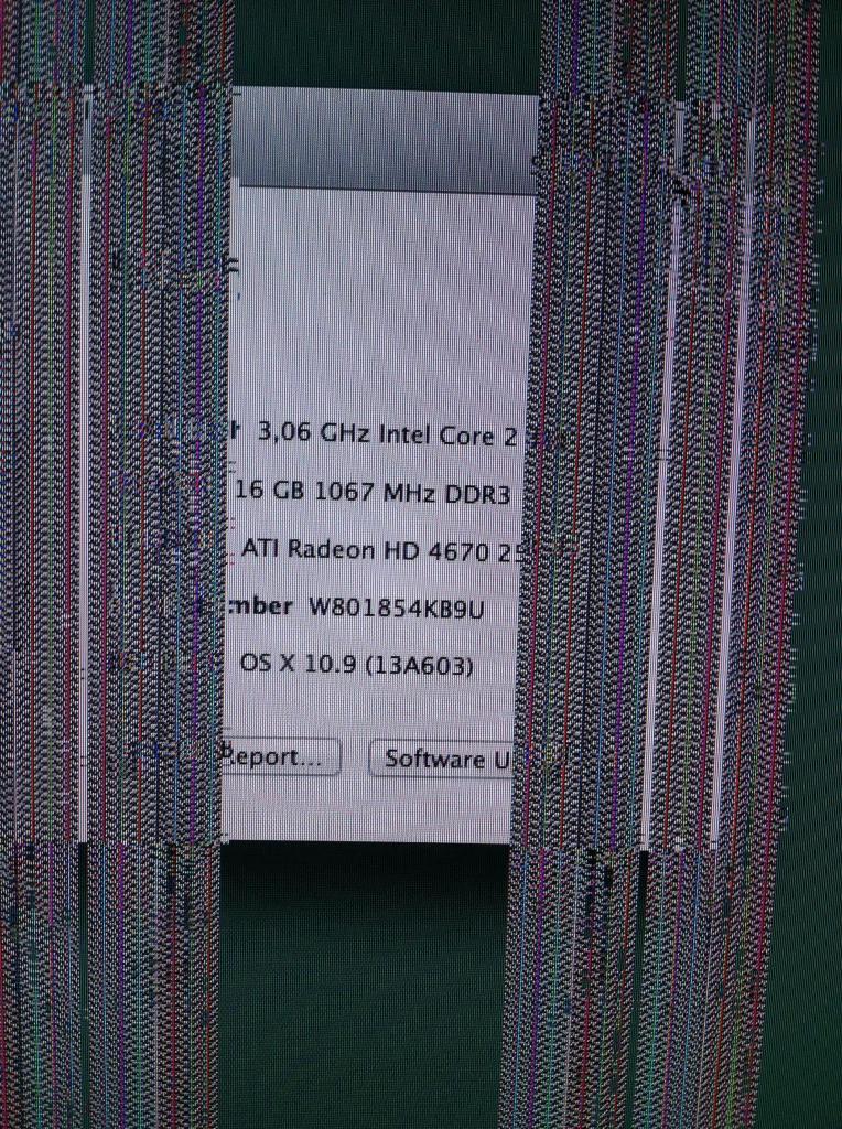

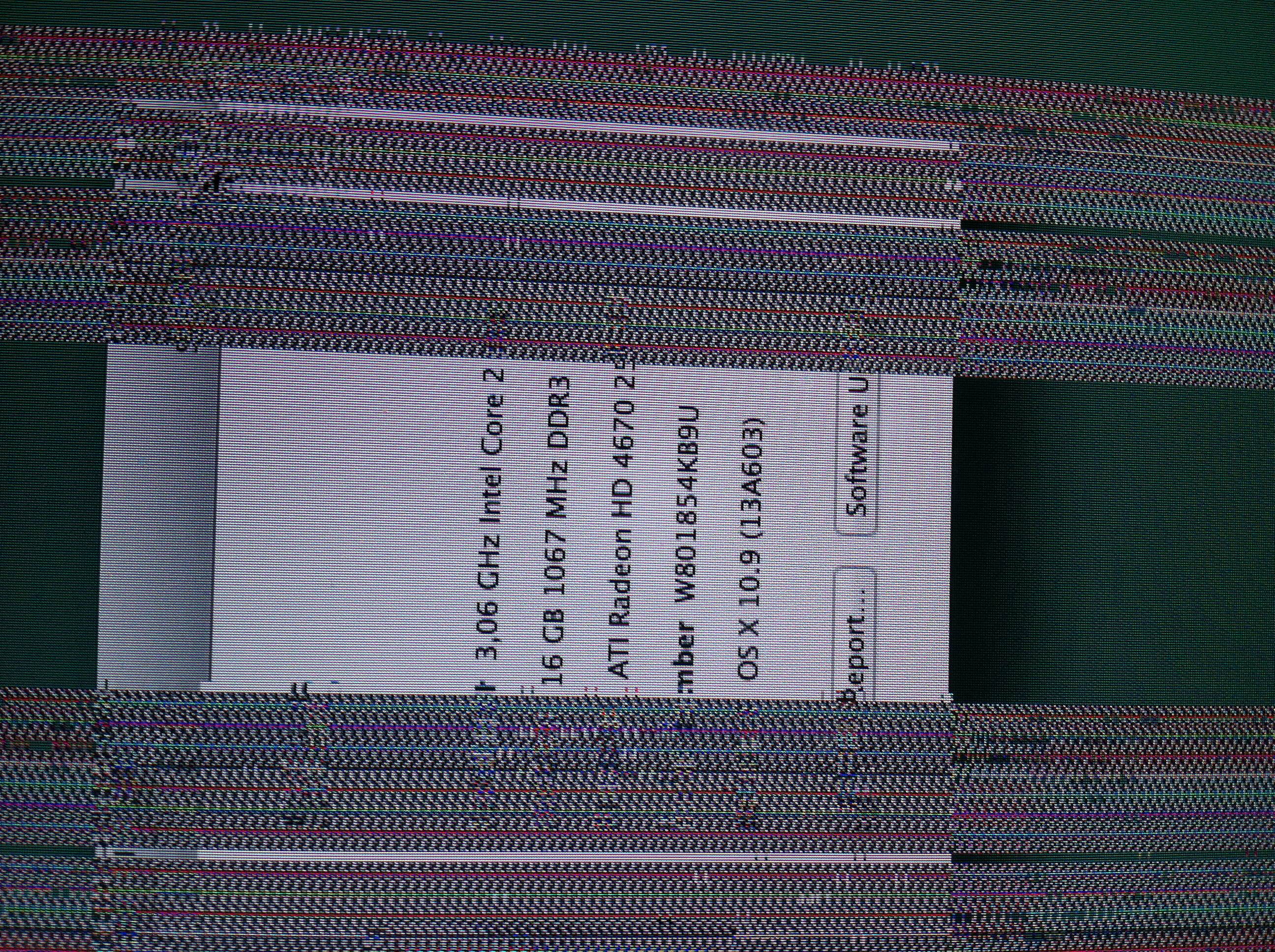

I did attach a picture of the about this mac section.

Same old story here. It was a corrupted video card due to overheating.
It will boot under OSX safe boot or Bootcamp safe mode because the drivers aren't loaded.
In my situation, when I boot in safe mode and keep it for a while or try to load some video stuff, the lines disappear and reappear. I had to install iStats pro and push the fans to the max to keep the card under control.
I ordered another iMac since mine was a late 2009 but long story short, it was the video card in my case.
